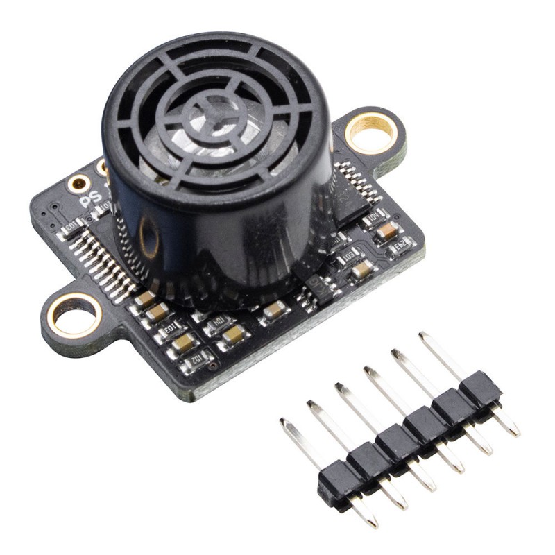

ماژول اولتراسونیک GY-US42 یک سنسور دقیق برای سنجش مسافت با استفاده از امواج صوتی است. این ماژول برای کاربردهای مختلفی از جمله رباتیک و فلایت کنترل‌ها مانند Pixhawk طراحی شده است. ماژول GY-US42 به وسیله‌ی ارسال و دریافت امواج صوتی، فاصله بین خود و یک جسم را تشخیص می‌دهد و اطلاعات را به کنترلر ارسال می‌کند.
پروتکل ارتباطی: I2C و UART
ولتاژ کاری: 3.3V – 5V
محدوده سنجش: 20mm تا 7200mm
دقت اندازه‌گیری: 1mm
ابعاد: 22mm x 22mm
GY-US42 is a low cost, high quality range sensor module.
Working voltage 3-5v, small power consumption, small size, easy installation.
Its working principle is that the probe emits ultrasonic waves, irradiated to the measured object, the probe receives the return sound waves, the use of time difference, calculate the actual distance. There are three ways to read the module data, that is, serial UART (TTL level), IIC, pulse PWM mode,
Serial baud rate of 9600bps and 115200bps, can be configured, there are continuous, ask the output in two ways, you can save the power settings.
IIC can modify the internal address, to facilitate an IIC bus at the same time access multiple modules. Pulse PWM output, same as SR04.
The module can be adapted to a different working environment and connected directly to the microcontroller.
When the computer needs USB to TTL module, direct connection.
IIC mode can be directly connected with Pixhawk, and other flight control.
Provide arduino, 51, stm32 microcontroller communication procedures, does not provide schematic and internal microcontroller source.
As a result of the use of transceiver integrated ultrasonic probe, ranging from the blind area is about 20cm. Within 20cm range is invalid.
Feature
Voltage:3-5V
Built-in MCU calculates distance
IIC and Serial and PWM
Frequency:15 HZ(full range)
Current:9mA (vcc=5v)
Applications
Robots
Teaching Libraries equipment
Production Testing
Four-axis aircraft
Anthropometric
Smart Car
Network disk data download:
https://pan.baidu.com/s/1eS7ZsPW
GY-US42 ultrasonic module Pixhawk APM dedicated ultrasonic module, I2C interface, plug and play,
Direct replacement for MB1242 MB1240
Pixhawk APM Reference Settings website:
Http://ardupilot.org/copter/docs/common-rangefinder-maxbotixi2c.html
