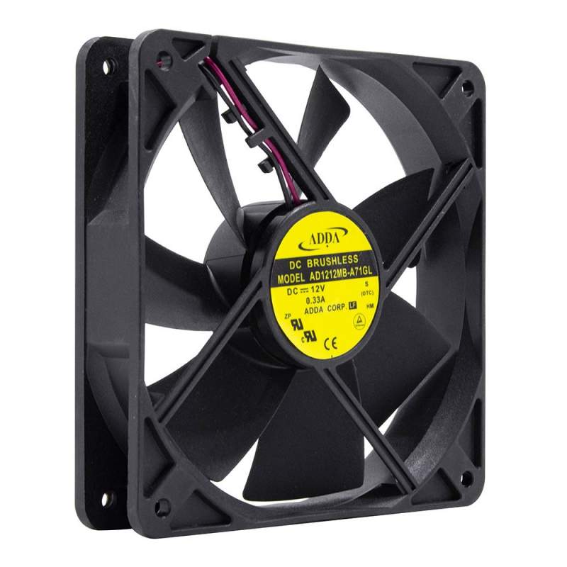

فن 12V دو سیمه سایز 12x12 ضخامت 2.5cm مارک ADDA مدل AD1212MB
کد کالا: 2301001179
فن دوسیمه 12x12cm مارک ADDA
Manufacturer: ADDA
Product Category: DC Fans
Type: Axial
Height: 120 mm
Depth: 25 mm
Width: 120 mm
Operating Supply Voltage: 12 VDC
Airflow: 80.5 CFM (2.3 m3/min)
Speed: 2050 RPM
Bearing Type: Ball
Noise: 38 dBA
Power Rating: 3.96 W
Housing Material: Plastic
Termination Style: Wire Leads
Series: AD 120x25
Brand: ADDA پ
Compliance: UL; CUL; TUV; CE
Current Type: DC
Pressure Type: 2.8 mmAq
Product Type: DC Fans
Subcategory: Fans, Blowers & Accessories
