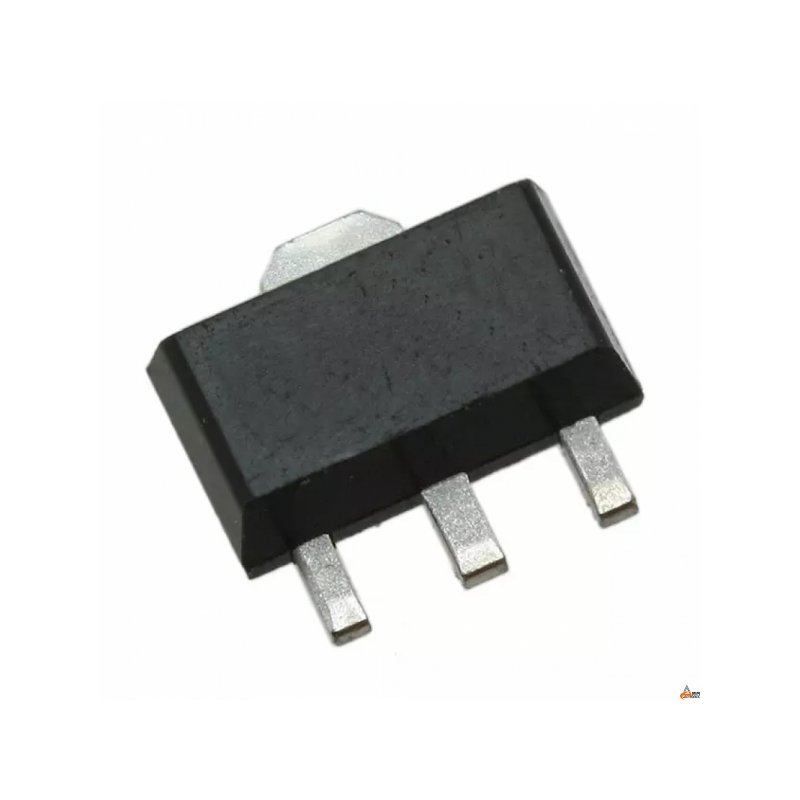

ترانزیستور BC869 نوع PNP پکیج SOT-89
کد کالا: 2111002142
ترانزیستور BC869 نوع PNP پکیج SMD SOT-89 ولتاژ 20V جریان 1A

Type Designator: BC869
Material of Transistor: Si
Polarity: PNP
Maximum Collector Power Dissipation (Pc): 1.35 W
Maximum Collector-Base Voltage |Vcb|: 32 V
Maximum Collector-Emitter Voltage |Vce|: 20 V
Maximum Emitter-Base Voltage |Veb|: 5 V
Maximum Collector Current |Ic max|: 1 A
Transition Frequency (ft): 40 MHz
Collector Capacitance (Cc): 28 pF
Forward Current Transfer Ratio (hFE), MIN: 160
