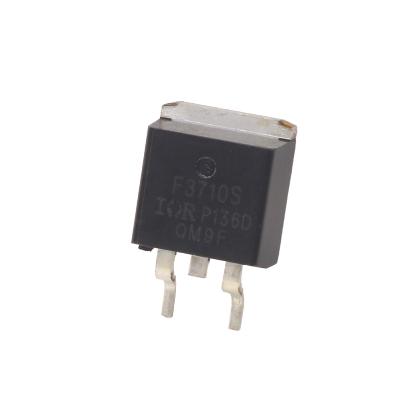

ماسفت IRF3710S نوع N-Channel پکیج TO-263 (D2PAK)
کد کالا: 2111001549
ماسفت IRF3710STRLPBF از نوع N-Channel ولتاژ 100 ولت و جریان 57 آمپر پکیج TO-263-3

Product Category: MOSFETs
Transistor Type: N-Channel
Technology: Si
Mounting Style: SMD/SMT
Package / Case: D2PAK-3 (TO-263-3)
Transistor Polarity: N-Channel
Number of Channels: 1 Channel
Vds - Drain-Source Breakdown Voltage: 100 V
Id - Continuous Drain Current: 57 A
Rds On - Drain-Source Resistance: 23 mOhms
Vgs - Gate-Source Voltage: - 20 V, + 20 V
Vgs th - Gate-Source Threshold Voltage: 4 V
Qg - Gate Charge: 130 nC
Pd - Power Dissipation: 200 W
Channel Mode: Enhancement
Configuration: Single
Fall Time: 47 ns
Forward Transconductance - Min: 32 S
Product Type: MOSFETs
Rise Time: 58 ns
Subcategory: Transistors
Typical Turn-Off Delay Time: 45 ns
Typical Turn-On Delay Time: 12 ns
