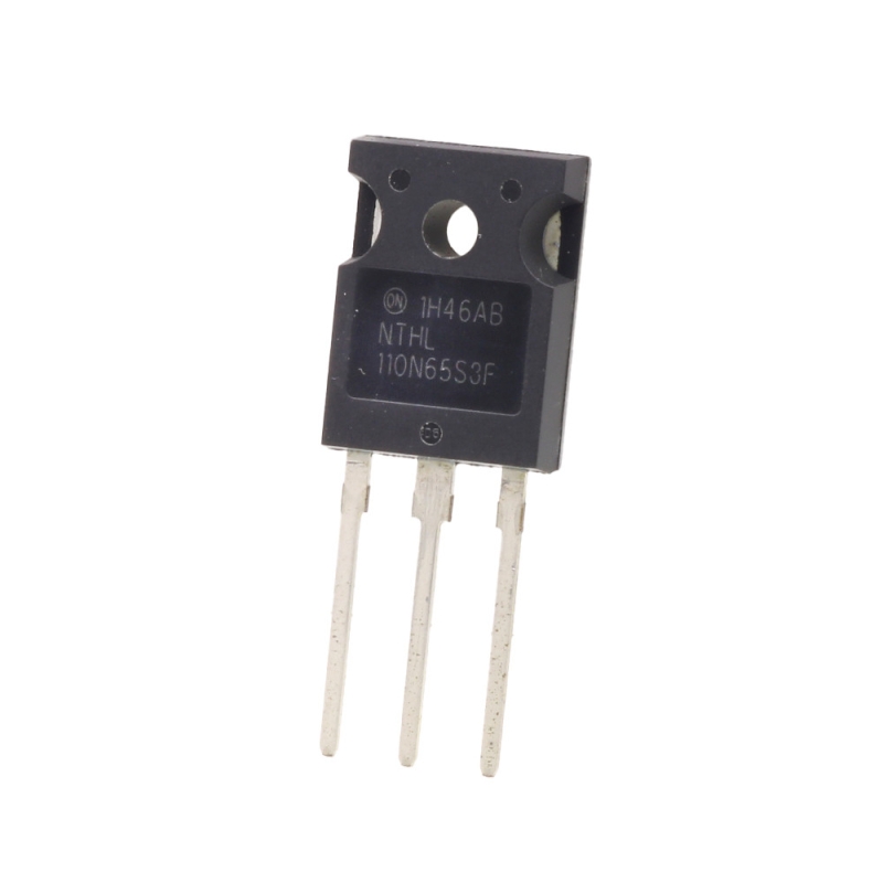

ماسفت قدرت NTHL110N65S3F نوع N-Channel مارک ON-Semiconductor پکیج TO-247
کد کالا: 2111001547
ماسفت قدرت 650 ولت 30 آمپر NTHL110N65S3F مارک ON-Semiconductor نوع N-Channel پکیج TO-247
Manufacturer: Onsemi
Product Category: MOSFETs
RoHS: Details
Technology: Si
Mounting Style: Through Hole
Package/Case: TO-247-3
Transistor Polarity: N-Channel
Number of Channels: 1 Channel
Vds - Drain-Source Breakdown Voltage: 650 V
Id - Continuous Drain Current: 30 A
Rds On - Drain-Source Resistance: 110 mOhms
Vgs - Gate-Source Voltage: - 30 V, + 30 V
Vgs th - Gate-Source Threshold Voltage: 3 V
Qg - Gate Charge: 58 nC
Pd - Power Dissipation: 240 W
Channel Mode: Enhancement
Series: SuperFET3
Packaging: Tube
Brand: onsemi
Configuration: Single
Fall Time: 16 ns
Forward Transconductance - Min: 17 S
Rise Time: 32 ns
Subcategory: Transistors
Typical Turn-Off Delay Time: 61 ns
Typical Turn-On Delay Time: 29 ns
