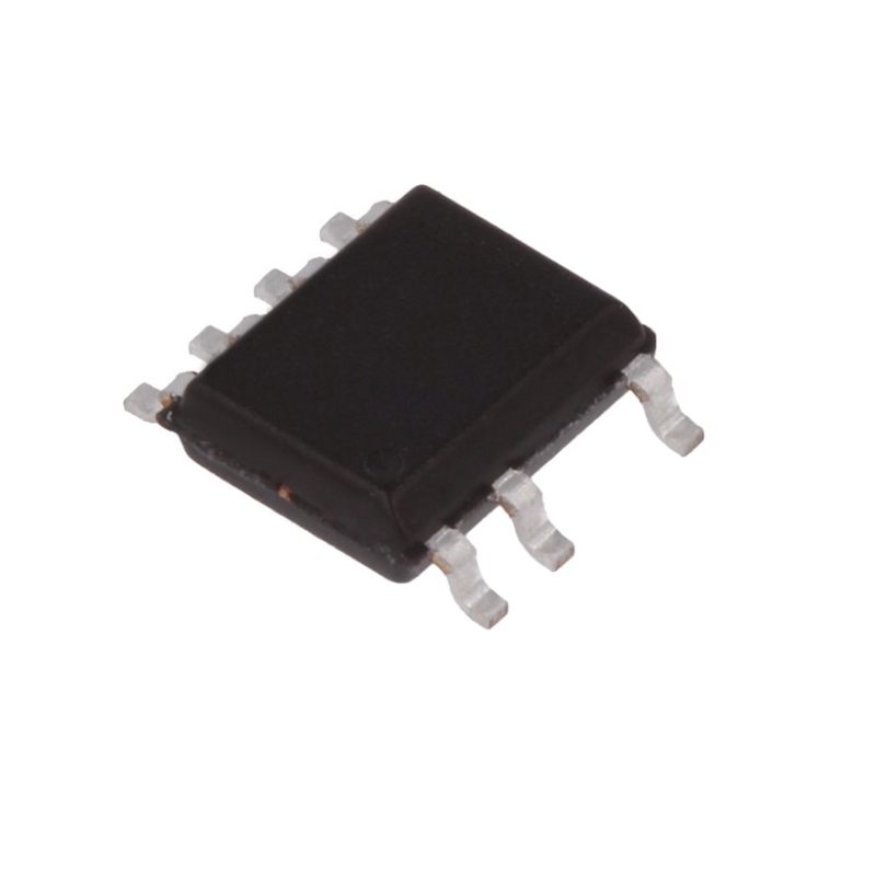

تراشه LED درایور DP9512B پکیج SO-7
کد کالا: 2101016014
آی سی درایور ال ای دی DP9512B پکیج SO-7
Description
The DP951X series is a highly integrated constant current LED power switch. The chip adopts a quasi-resonant working mode and does not require an auxiliary winding to detect degaussing. At the same time, it integrates high-voltage 500V power MOSFET and high-voltage self-powered circuit, which simplifies the system design and production costs. The chip integrates high-precision inductor current sampling technology to obtain high Accurate constant current output, and the output line voltage and load regulation rate table DP951X integrates complete protection functions to ensure system safety and reliability
Features
Integrated high-voltage 500V MOSFET
Integrated high-voltage self-powered circuit
No VDD capacitor design
Integrated 600V freewheeling diode design
 ±5% constant current accuracy
Quasi -resonant mode works with high efficiency
Ultra -low operating current
Excellent line voltage and load regulation
Internal protection function:
Cycle-by-cycle current limit (OCP)
Leading edge blanking (LEB)
LED short circuit protection
Overheating protection (OTP)
Package type SOP-7
Application
LED Candle Light
LED Bulb
Other LED Lighting
