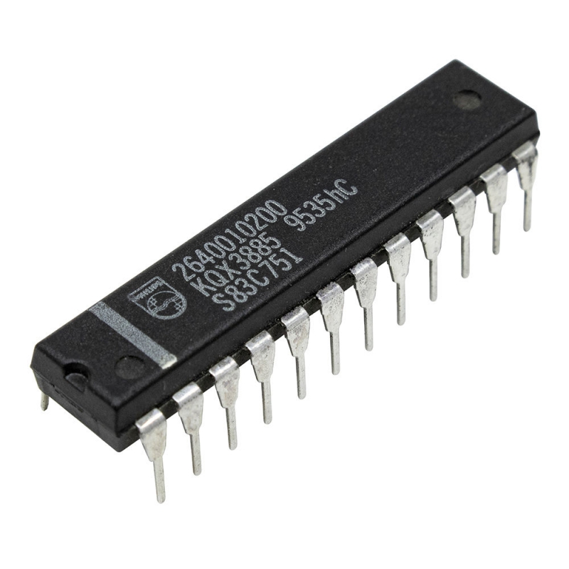

میکروکنترلرS83C751 پکیج DIP مارک Philips
کد کالا: 2091005003
میکروکنترلر 8 بیتی 24 پایه فرکانس 16MHz پکیج DIP مارک Philips Semiconductors

The Philips 83C751/87C751 offers the advantages of the 80C51 architecture in a small package and at low cost. The 8XC751 Microcontroller is fabricated with Philips high-density CMOS technology. Philips epitaxial substrate minimizes CMOS latch-up sensitivity. The 8XC751 contains a 2k × 8 ROM (83C751) EPROM (87C751), a 64 × 8 RAM, 19 I/O lines, a 16-bit auto-reload counter/timer, a five-source, fixed-priority level interrupt structure, a bidirectional inter-integrated circuit (I2C) serial bus interface, and an on-chip oscillator. The on-board inter-integrated circuit (I2C) bus interface allows the 8XC751 to operate as a master or slave device on the I2C small area network. This capability facilitates I/O and RAM expansion, access to EEPROM, processor-to-processor communication, and efficient interface to a wide variety of dedicated I2C peripherals.
Feature
• 80C51 based architecture
• Inter-Integrated Circuit (I2C) serial bus interface
• Small package sizes
– 24-pin DIP (300 mil “skinny DIP”)
• 87C751 available in one-time programmable plastic packages
• Wide oscillator frequency range
• Low power consumption:
– Normal operation: less than 11mA @ 5V, 12MHz
– Idle mode
– Power-down mode
• 2k × 8 ROM (83C751)
• 16-bit auto reloadable counter/timer
• Fixed-rate timer
• Boolean processor
• CMOS and TTL compatible
• Well suited for logic replacement, consumer and industrial applications
• LED drive outputs
