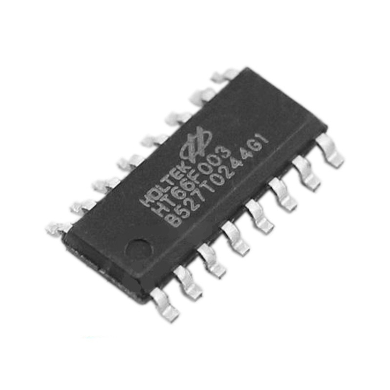

میکروکنترلر 8 بیتی 16 پایه HT66F003 ساخت شرکت HOLTEK با فرکانس کاری 8MHz
451,000 ریال
The devices are Flash Memory type 8-bit high performance RISC architecture microcontrollers. Offering users the convenience of Flash Memory multi-programming features, these devices also include a wide range of functions and features. Other memory includes an area of RAM Data Memory as well as an area of true EEPROM memory for storage of non-volatile data such as serial numbers, calibration data etc.
Analog features include a multi-channel 12-bit A/D converter function. Multiple and extremely flexible Timer Modules provide timing, pulse generation, capture input, compare match output,
single pulse output and PWM generation functions. Protective features such as an internal Watchdog Timer and Low Voltage Reset coupled with excellent noise immunity and ESD protection ensure that reliable operation is maintained in hostile electrical environments.
A full choice of HIRC and LIRC oscillator functions are provided including a fully integrated system oscillator which requires no external components for its implementation.
The inclusion of flexible I/O programming features, Time Base functions along with many other features ensure that the devices will find excellent use in applications such as electronic metering,environmental monitoring, handheld instruments, household appliances, electronically controlled tools, motor driving in addition to many others.
Operating Voltage
fSYS = 8MHz: 2.2V~5.5V
Up to 0.5μs instruction cycle with 8MHz system clock at VDD=5V
Power down and wake-up functions to reduce power consumption
Two Oscillators
Internal High Speed 8MHz RC -- HIRC
Internal Low Speed 32kHz RC -- LIRC
Fully intergrated internal oscillator requires no external components
Multi-mode operation: NORMAL, SLOW, IDLE and SLEEP
All instructions executed in one or two instruction cycles
Table read instructions
61 powerful instructions
Up to 4-level subroutine nesting
Bit manipulation instruction
Flash Program Memory: 1K×14/2K×15
RAM Data Memory: 64×8/96×8
True EEPROM Memory: 32×8
Watchdog Timer function
Up to 18 bidirectional I/O lines
Software controlled 4-SCOM lines LCD driver with 1/2 bias (only available for HT66F004)
Multiple pin-shared external interrupts
Multiple Timer Modules for time measure, compare match output, capture input, PWM output,
single pulse output functions
Dual Time Base functions for generation of fixed time interrupt signals
Multi-channel 12-bit resolution A/D converter
Low voltage reset function
Wide range of available package types
Flash program memory can be re-programmed up to 10,000 times
Flash program memory data retention > 10 years
True EEPROM data memory can be re-programmed up to 100,000 times
True EEPROM data memory data retention > 10 years
