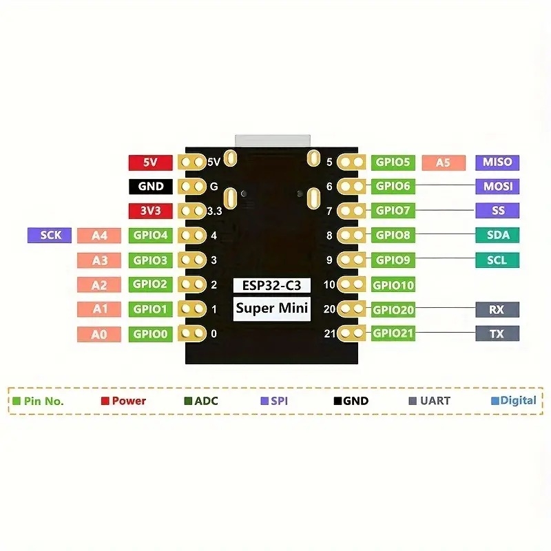

ESP32-C3-SuperMini is a tiny in size with castellated holes, making them easy to integrate into other host boards.
The ESP32-C3-SuperMini features a Type-C USB connector and makes most of its pins accessible in a compact design. It uses the ESP32-C3FN4 chip, which includes low-power WiFi and Bluetooth 5, along with 4MB of flash memory. This chip also has built-in security features like an encryption accelerator, random number generator (RNG), hardware-based message authentication code (HMAC), and digital signature modules, making it suitable for secure IoT applications.
Additionally, the ESP32-C3-SuperMini supports various power-saving modes, making it ideal for IoT projects, mobile devices, wearable tech, and smart home devices
Feature
Low-power SoC equipped with RISC-V 32-bit single-core processor, up to 160MHz main frequency.
Supports 2.4GHz Wi-Fi (802.11 b/g/n) and Bluetooth® 5 (LE).
400KB of SRAM and 384KB ROM, and 4MB of onboard Flash memory.
Castellated module and onboard ceramic antenna, allow soldering direct to carrier boards.
Supports flexible clock, module power supply independent setting, and other controls to realize low power consumption in different scenarios.
Integrated with USB serial port full-speed controller, 15 × GPIO pins allow flexible configuring pin functions.
3 × SPI, 1 × I2C, 2 × UART, 1 × I2S, 2 × ADC, etc.
Hardware Discription

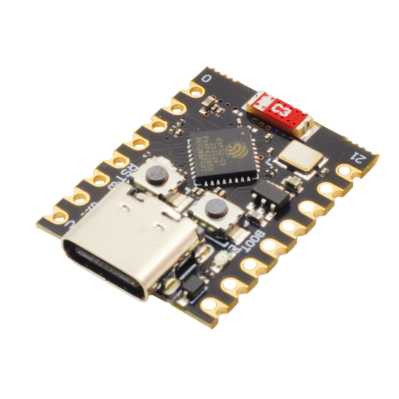

Antenna Placement: When using daughterboards, avoid covering the ceramic antenna with any components such as PCBs, metal, or plastic, as this could interfere with the signal.
GPIO Pins: GPIO12 to GPIO17 are not exposed because they are used internally for the 4MB Flash memory.
USB to UART Chip: The ESP32-C3-Mini does not use a USB to UART bridge chip. When flashing firmware, you need to hold the BOOT button (connected to GPIO9) while connecting the board via the Type-C USB cable. This puts the device into the download mode necessary for flashing firmware.
UART Pins: The “TX” and “RX” markings on the board indicate the default UART0 pins, where TX is connected to GPIO21 and RX to GPIO20​
