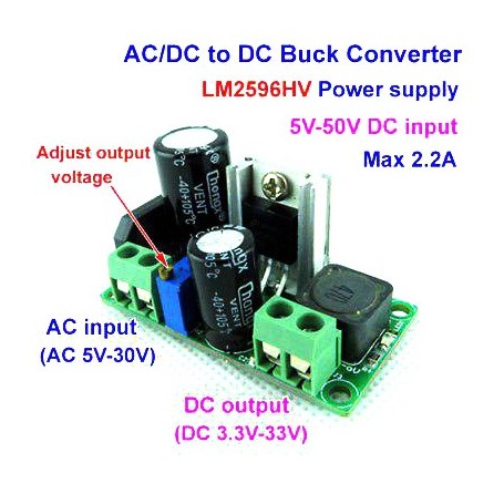

ولتاژ ورودی از 5v تا DC 50v و 5v تا AC 30v
ماژول تغذیه کاهنده LM2596HV که در بازه ولتاژ ورودی از 5v تا DC 50v و 5v تا AC 30v با جریان 2.2A خروجی قابل تنظیم 3.3v الی 30v را ارائه می دهد.
مشخصات :
محدوده ولتاژ ورودی: AC 5V-30V، DC 5V-50V
محدوده ولتاژ خروجی: DC 3.3V-33V
محدوده جریان خروجی: تا 2.2 آمپر (تراشه رگولاتور می‌تواند حداکثر 3 آمپر جریان را تحمل کند و می‌تواند به صورت کوتاه‌مدت در جریان خروجی 3 آمپر کار کند)

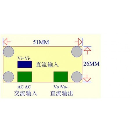

اندازه ماژول: 51 میلی‌متر × 26 میلی‌متر

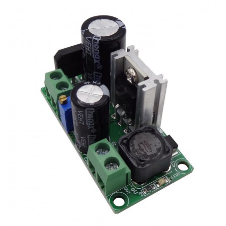

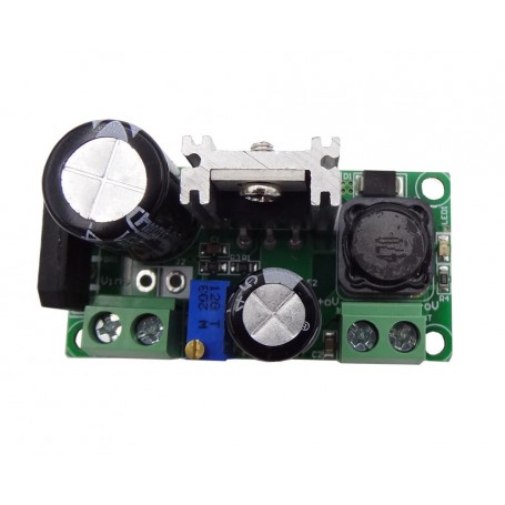

The power module adopts plug-in LM2596HV, high-voltage version LM2596. The maximum input voltage is 50 V (limited by the filter capacitor withstand voltage). The external heat sink can withstand high current treatment. The input terminal uses a 4A rectifier bridge stack for AC power input and has a dedicated DC input port commonly used for AC and DC input. The output voltage is adjustable from 3.3 V to 33 V and the output voltage will vary with different input voltage ranges.
Due to the large fluctuation of the AC voltage, the AC voltage AC5V-AC30V or DC5V-50V input has allocated margin to the recommended AC voltage range. The power module has a maximum input voltage of 50 V (limited by the filter capacitor withstand voltage) and a heat sink. The output current can run consistently at 2.2A output current for a long time and can operate at 3A output current for a short time. The front part of the pcb has the name of the silk screen terminal and the back side has the name of the silk screen terminal. When soldering the lead, please recognize it and solder to prevent damage.
Input voltage range: AC 5V-30V, DC 5V-50V
Output output range: DC 3.3V-33V
Output current range: up to 2.2A (regulator chip, can withstand a maximum of 3A current, can operate briefly at 3A output current)
Module size: 51mm * 26mm
