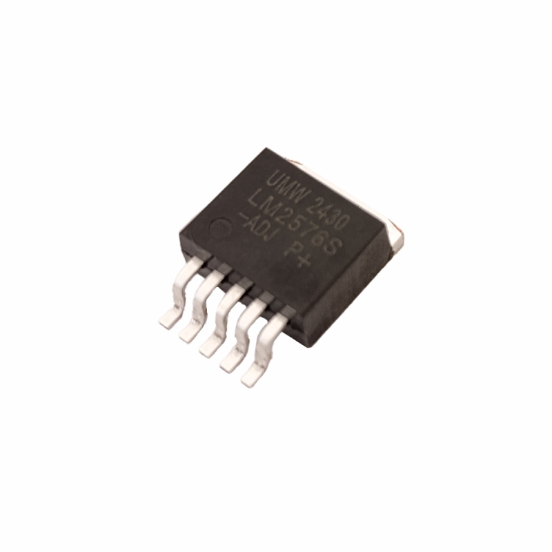

رگولاتور متغیر LM2576S - ADJ پکیج TO-263 مارک UMW
کد کالا: 2120001195
رگولاتور ولتاژ قابل تنظیم LM2576S پکیج TO-263 / D2PAK مارک UMW
1,160,000 ریال
Manufacturer: UMW
Product Category: Adjustable Voltage Regulators
Mounting Style: SMD/SMT
Package / Case: TO-263 / D2PAK
Topology: Buck
Output Voltage: 1.23 V to 37 V
Output Current: 3 A
Number of Outputs: 1 Output
Input Voltage, Min: 4 V
Input Voltage, Max: 45 V
Quiescent Current: 5 mA
Switching Frequency: 52 kHz
Series: LM2576
Input Voltage: 4 V to 45 V
Moisture Sensitive: Yes
Operating Supply Current: 5 mA
Product Type: Switching Voltage Regulators
Subcategory: PMIC - Power Management ICs
Supply Voltage - Min: 4 V
