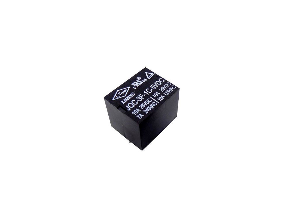

رله 7 آمپر 240 ولت AC و 10 آمپر 28 ولت DC دارای 1 کنتاکت 5 پایه لیمینگ Liming
Outline Dimension(L×W×H): 19×15.5×15.5
Dielectric Strengh Between Open Contact: 750VAC
Contact Form: 1A,1B,1C
Between Coil and Contact: 1500VAC
Contact Resistance: 100 mΩ
Coil Voltage: 5VDC ~ 48VDC
Electrical: 10^5
Mechanical: 10^7
Pick-up Voltage: ≤75%
Temperature Range: -40~ +70℃
Release Voltage: ≥10%
Coil Power(W): 0.36
Contact transfer Current(A): 15A
Mounting Form: PCB Terminal
Contact Rating: 10A 120VAC
7A 240VAC
10A/15A 28VDC
Weight: 10g
Insulation Resistance: 100 MΩ
