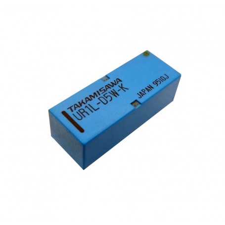

Subminiature polarized relay
● Excellent high frequency characteristics
—Isolation : minimum 60 dB
—Insertion loss: maximum 1 dB
—V.S.W.R. : maximum 1.2 }
● High reliability—Bifurcated contacts
● Wide operating range
● DIL pitch terminals
● Plastic sealed type backfilled with nitrogen
