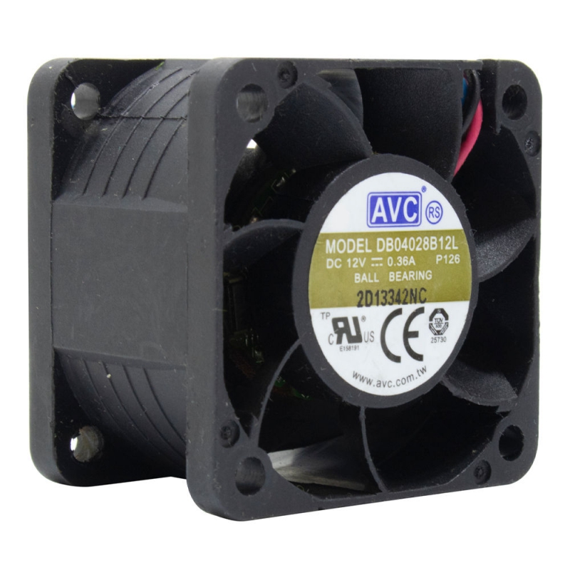

Manufacturer: AVC
Subcategory: Fans, Blowers & Accessories
Product Category: DC Fans
Type: Axial
Height: 40 mm
Width: 40 mm
Depth: 28 mm
Rated Voltage: 12VDC
Operation Voltage: 7 - 13.2VDC
Input Current: 0.36A
Power Rating: 4.36W
Speed: 8000 RPM
Airflow: 13.86 CFM
Air Pressure: 0.456 inchH2O
Noise: 40.1 dBA
