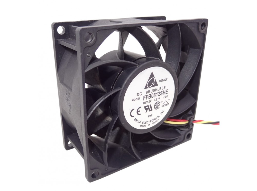

جت فن بلبرینگی 12 ولت 6.96 وات دلتا DELTA سه سیمه دور بالا مدل FFB0812SHE با ابعاد 8x8x3.8 سانتی متر
5
(6 رأی‌دهنده)
Manufacturer: Delta Electronics
Product Category: DC Fans
RoHS: Details
Type: Tubeaxial
Height: 80 mm
Depth: 38 mm
Width: 80 mm
Operating Supply Voltage: 12 VDC
Airflow: 68.5 CFM (1.94 m3/min)
Speed: 4900 RPM
Bearing Type: Ball
Noise: 48.5 dBA
Power Rating: 6.96 W
Features: Tachometer
Housing Material: Plastic
Termination Style: Wire Leads
Series: FFB
Pressure Type: 14 mmAq
Brand: Delta Electronics
Current Type: DC
Product Type: DC Fans
