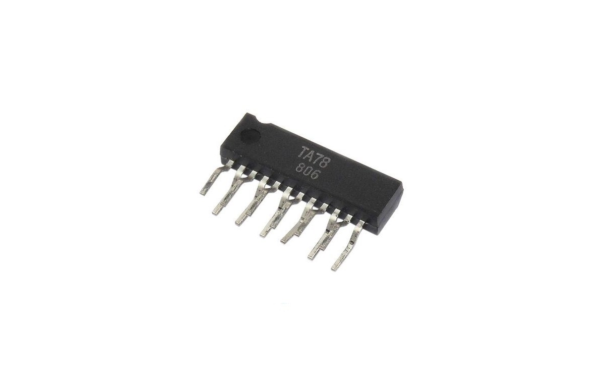

ترانزیستور اری TA78 نوع NPN پکیج SIP 10Pin ولتاژ40V جریان 100mA
Description
The TA78 NPN Epitaxial Planar Silicon Transistor Array has Five NPN transistors packaged in a SIP with staggered leads and features compact design for PC board mounting.
LF 12 Pin Package
All share common emitter.
Vcbo: 50V
Vceo: 40V
Vebo: 5V
Ic: 100Ma
Pc: 50mW
Hfe: 50
Ft: 150MHz
MFG: Rohm
MPN: TA78
