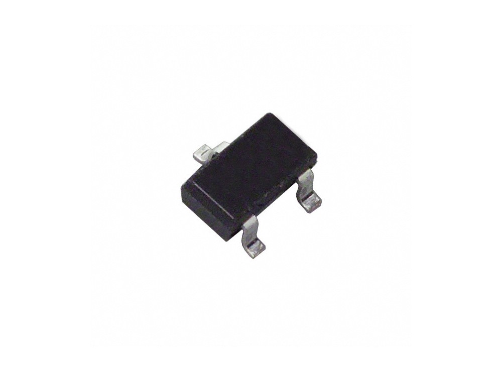

Type Designator: MMBT2222A
Material of Transistor: Si
Polarity: NPN
Maximum Collector Power Dissipation (Pc): 0.35 W
Maximum Collector-Base Voltage |Vcb|: 75 V
Maximum Collector-Emitter Voltage |Vce|: 40 V
Maximum Emitter-Base Voltage |Veb|: 6 V
Maximum Collector Current |Ic max|: 0.6 A
Max. Operating Junction Temperature (Tj): 175 °C
Transition Frequency (ft): 300 MHz
Collector Capacitance (Cc): 8 pF
Forward Current Transfer Ratio (hFE), MIN: 100
Package: SOT23
