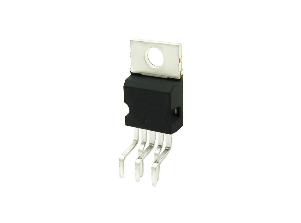

تراشه آمپلی فایر TDA2030A
کد کالا: 2101012004
آی سی تقویت کننده آمپلی فایر 18 وات TDA2030A
100 2% 51,156‎ تومان
500 3% 50,634‎ تومان
522,000 ریال
Product Category: Audio Amplifiers
RoHS: Details
Series: TDA2030A
Product: Audio Amplifiers
Class: Class-AB
Output Power: 18 W
Mounting Style: Through Hole
Type: 1-Channel Mono
Package / Case: Pentawatt
Audio - Load Impedance: 8 Ohms
THD plus Noise: 0.5 %
Packaging: Tube
Description/Function: Speaker
Height: 9.2 mm
Input Type: Differential
Length: 10.4 mm
Output Current: 3500 mA
Supply Type: Dual
Width: 4.8 mm
Brand: STMicroelectronics
Gain: 80 dB
Number of Channels: 1 Channel
Dual Supply Voltage: +/- 9 V, +/- 12 V, +/- 15 V, +/- 18 V
Ib - Input Bias Current: 2 uA
Maximum Dual Supply Voltage: +/- 22 V
Minimum Dual Supply Voltage: +/- 6 V
Operating Supply Current: 80 mA
Operating Supply Voltage: 22 V
Output Signal Type: Single
Pd - Power Dissipation: 20000 mW
Product Type: Audio Amplifiers
PSRR - Power Supply Rejection Ratio: 54 dB
