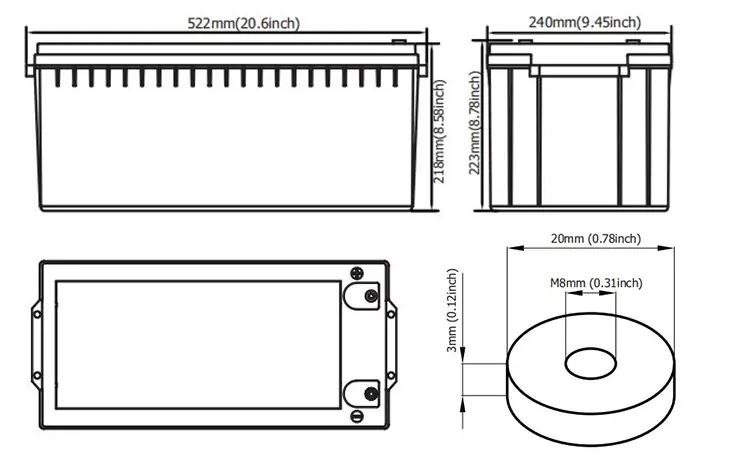

Approximate dimensions (L×W×H) Approx. 330×175×210 mm (depending on the final model)
