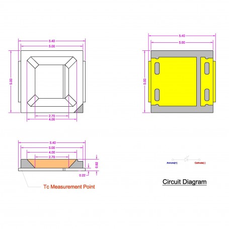

Compact package size at 5.0mm*5.4mm.
Voltage:3.0-3.2V
Lumen:35-40LM
Current : 350mA
Power : 1 W
CCT:3000-3200K
