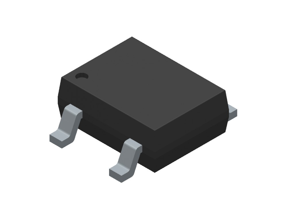

پل دیود 1000V-1.5A مربعی DB157S پکیج DB-LS
کد کالا: 2041002083
پل دیود 1000ولت - 1.5آمپر
10 1% 8,821‎ تومان
50 2% 8,732‎ تومان
100 3% 8,643‎ تومان
89,100 ریال
Type: Single Phase Bridge
Mounting Style:     SMD/SMT
Termination Style:     SMD/SMT
Package / Case:     DBS
Peak Reverse Voltage:     1000 V
Vf - Forward Voltage:     1.1 V
Max Surge Current:     40 A
Minimum Operating Temperature:     - 55 C
Maximum Operating Temperature:     + 150 C
Length:     8.8 mm
Width:     6.5 mm
Height:     3.4 mm
Series:     DB15
Packaging:     Reel
Brand:     Rectron
Ir - Reverse Current:     5 uA
Product Type:     Bridge Rectifiers
