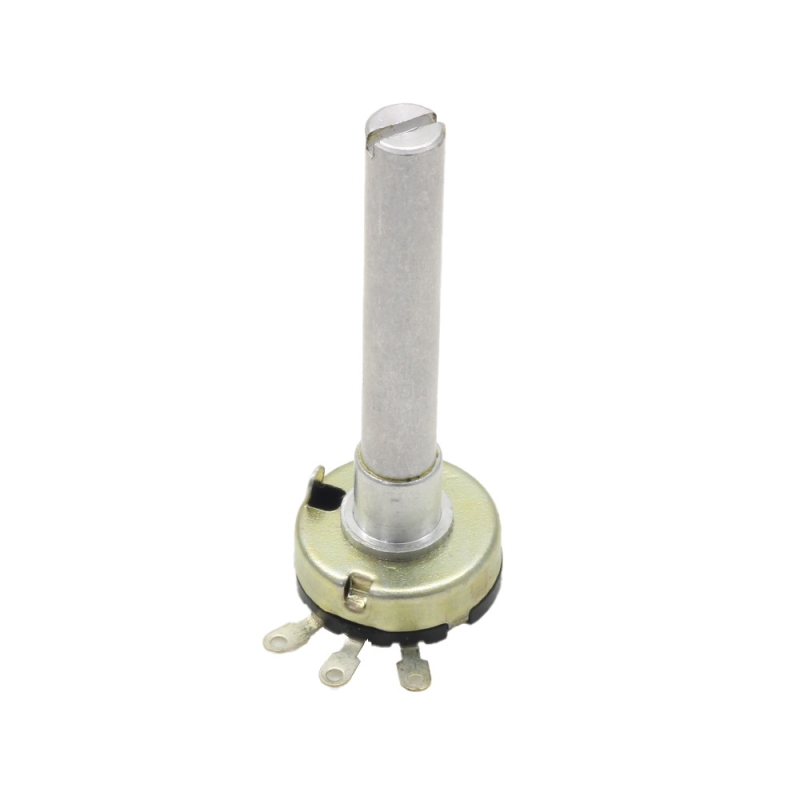

ولوم 5K اهم مدل TP R-17SP-5K شفت بلند
443,000 ریال

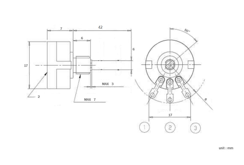

model : R-17SP
Nominal Total Resistance : 5 kΩ
Total Resistance Tolerance : Within ±10% of the nominal total resistance
Insulation Resistance : 100MΩ at DC500V
Dielectric Strength : AC500V for 1 minute
Total Rotational Angle : 260±5°
Rotational Torque : 2 to 20 mN・m
Mounting style : panel mount type
Operating Temperature Range : -10 to 85℃
Rated Power : 0.1W - 0.05W
Maximum Operating Voltage in AC mode : 200V - 160V
Maximum Operating Voltage in DC mode : 30V - 50V
