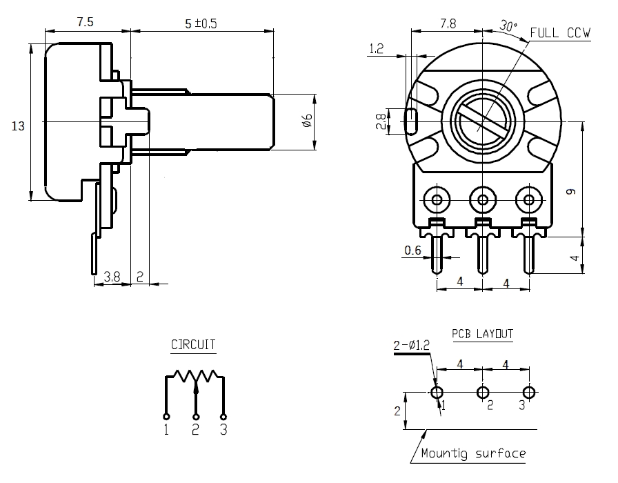

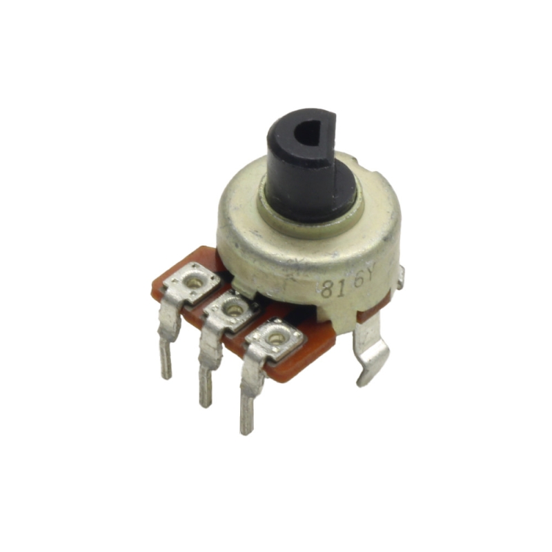

Product Name:RK16212GO
Summary information:
RK162/RK163
Mechanical properties
Rotating angle:300°±5°
Rotating moment:20~200gf.cm
Location driving force:50~300gf.cm
Stop Strength:5kgf.cm
Axis Push-pull Strength:8kgf.cm
Electrical properties
Total resistance range: 500Ω—1M
Total Resistance Tolerance: ±20%
Resistance Characteristic Curve: A B C D
Load power:0.05W
Residual Resistance: R≤10KΩ 10Ω
10K<R<25KΩ 20Ω
R≥250K 0.1%max.of total resistance
Maximum operating voltage: 50V AC/12V DC
Rotating murmur:≤100mV
Insulation resistance:100MΩ at 500V DC
Voltage withstand:1 minute at 300V AC
Synchronization error: 4dB at –40~0Db
Rotation life:10,000 cycles
