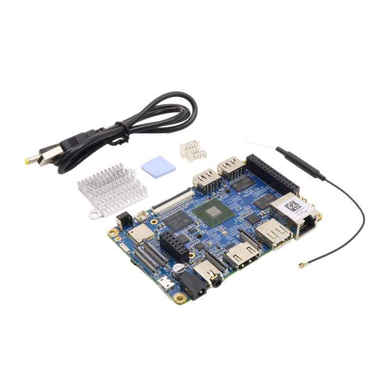

محتویات بسته‌بندی
  • یک عدد برد NanoPC-T3 Plus
  • یک عدد هیت سینک
  • یک عدد عایق سیلیکونی
  • اسپیسر نصب هیت سینک روی پردازنده
  • یک کابل USB به جک آداپتوری سوزنی

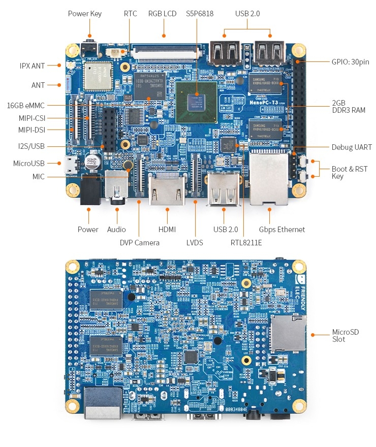

SoC Samsung S5P6818 Octa-Core Cortex-A53, 400M Hz - 1.4G Hz
PMU Power Management Implemented by a Cortex-M0 MCU, support software power-off, sleep and wakeup functions
System Memory 2GB 32bit DDR3 RAM
SD Storage 1 x microSD Card Socket
Ethernet Gbit Ethernet(RTL8211E)
WiFi 802.11b/g/n
Bluetooth 4.0 dual mode
Antenna Porcelain Antenna IPX Interface
eMMC 16GB
Video Input DVP Camera/MIPI-CSI (two camera interfaces)
Video Output HDMI Type-A / LVDS / Parallel RGB-LCD / MIPI-DSI (four video output interfaces)
Audio 3.5 mm audio jack / via HDMI
Microphone onboard Microphone
LCD Interface 0.5mm pitch 45 pin FPC seat, full color RGB 8-8-8
HDMI 1.4A Type A, 1080P
DVP Camera 0.5mm pitch 24 pin FPC seat
GPIO 2.54 mm pitch 30 pin-header
I2S/USB 2.54 mm pitch 14 pin-header
Serial Debug Port 2.54mm pitch 4-pin-header
User Key power, Reset, boot selection
LED 1 x power LED and 1 x system LED
Other Resources CPU’s internal TMU
RTC Battery RTC Battery Seat
Heat Sink 1 x Heat Sink with mounting holes
PCB Six Layer
Dimension 100 mm x 64 mm
Working Temperature -40"C to 80"C
OS/Software uboot, Android and Debian
