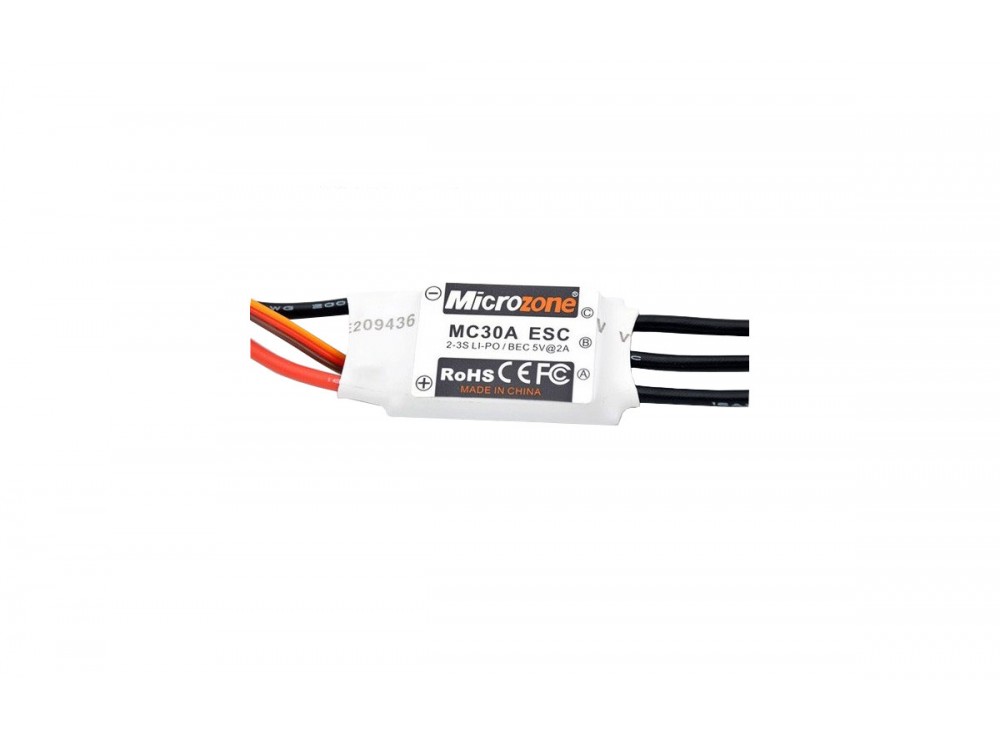

Output capacity: continuous current 30A, instantaneous current 36A (not less than 10 seconds);
Power input: 2-3 lithium battery pack
BEC output: 5V @ 2A (linear regulator mode - linear mode);
Throttle signal frequency range (Refresh rate): 50Hz-432Hz;
Size: 48mm (length) * 25mm (width) * 9.5mm (height);
Weight: 38g;
Safe power-on function: When the power is turned on, the throttle stick will not start the motor immediately in any position to avoid personal injury.
No need to adjust the throttle stroke adjustment,
Program settings: available on the remote control throttle sticks into a brake or no brake mode
 ● The company's electric transfer factory without brake mode
 ● Brake mode setting: remote start, the maximum throttle, electric power at the same time issued a rapid "beep" warning sound, throttle call to the minimum to hear the "beep" warning sound, the brake mode is set to complete;
 ● Brake settings: no brakes / brakes;
 ● Battery type: lithium battery;
 ● Low-voltage protection mode: soft-off / hard-off;
 ● Low-voltage protection threshold: low / medium / high; adaptive;
 ● Start mode: soft;
 ● Angle: low / medium / high; comprehensive protection:
 ● Undervoltage protection: when the battery voltage is lower than the protection threshold, the ESC automatically reduce the output power;
 ● Over-voltage protection: the input voltage exceeds the input allow range does not start, automatic protection, and issued a rapid "beep" warning tone;
 ● Overheat protection: built-in temperature detection circuit, when the electric temperature is too high automatically reduce the output power;
 ● loss of remote control signal loss: 1 second after the loss of remote control signal to reduce power, and then there is no remote control signal for 2 seconds to turn off the output;
 ● MC electrical control software and MC remote control software in the design of consistency, so with the MC remote control, electric transfer performance is more good;
