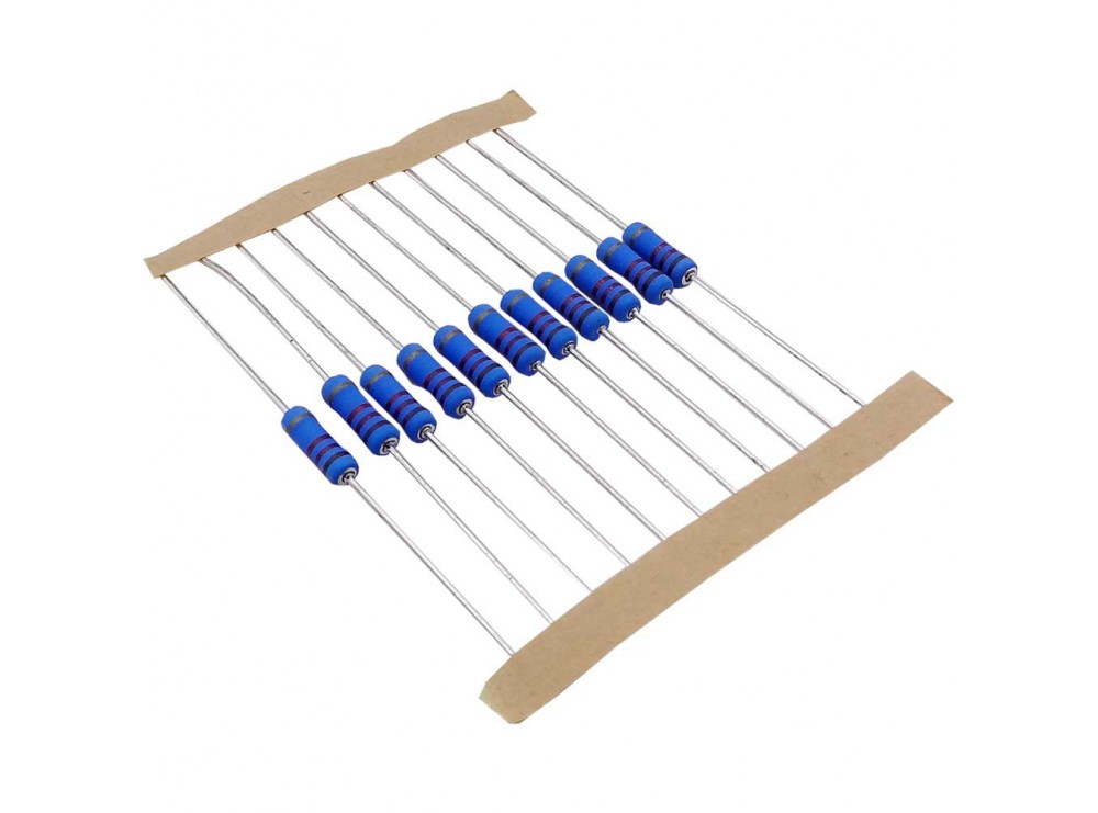

FEATURES
Excellent mechanical and thermal shock at a high temperature
• Flameproof overloaded owing to the flame-resistant coating
• Suitable to pulse circuits
• Coating Color: Blue(MOR 1W, 2W), Green(MORS 1W, 2W, 3W)
• Miniature size(MORS 1W, 2W, 3W)result in 50% space saving
• Marking: Color Code
TYPE: MORSE 1W
Power Rating: 1W
Max. Working Voltage: 350V
Max Overload Voltage: 600V
Rating Ambient Temp:+70
Operating Temp Range: -55 to +235
TAPING DIMENSIONS
مقاومت متال اکسید 1.2K اهم 1W کره ای مارک ABCO سری MOR بسته 50 تایی
TYPE: MOR 1W, P=12.7mm, W=5mm, H1=16.5mm, H=16mm
