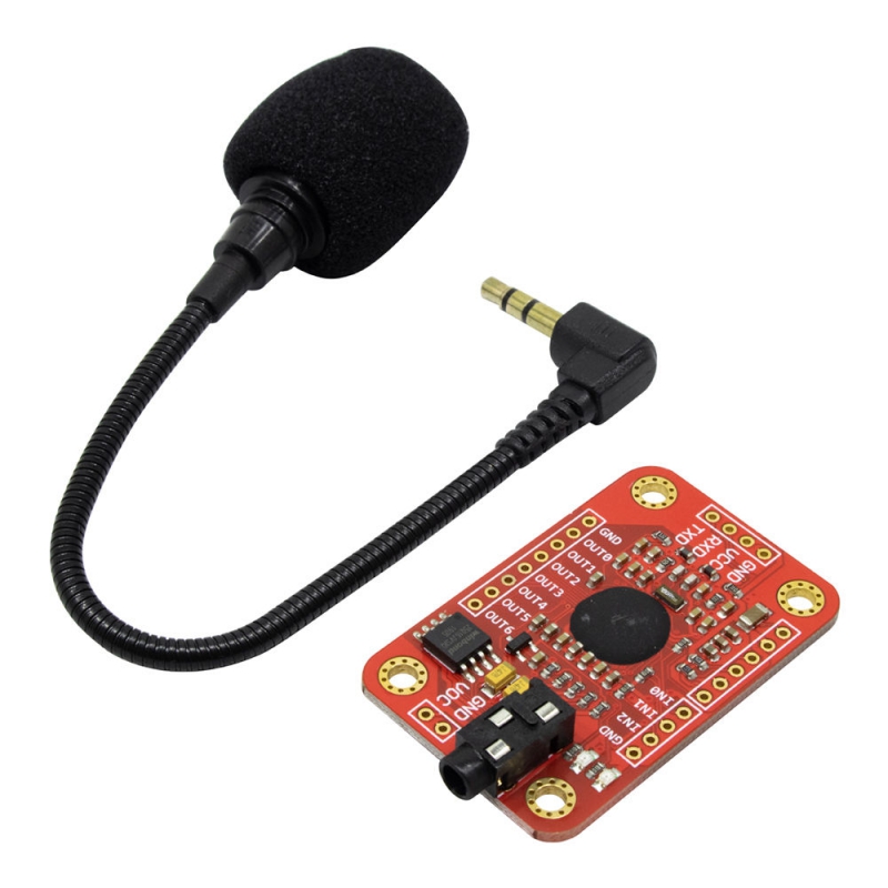

The ELECHOUSE Voice Recognition Module V3 is a compact, speaker-dependent voice command recognition board designed for voice-controlled electronic projects. This module allows users to train their own voice commands, enabling reliable recognition of customized sounds or words without requiring complex signal processing on the main controller. Each trained sound is stored internally and can later be recognized and mapped to specific actions.
Unlike earlier versions, version V3 stores all trained voice commands in a single unified memory pool. From this library of up to 80 recorded commands, any 7 commands can be loaded into the recognizer at the same time, allowing flexible and dynamic control strategies. This architecture removes the limitations of grouped command storage found in previous generations and simplifies command management.
The module supports two control methods. Full control is available through the UART serial interface, allowing command training, loading, deletion, and configuration via software. Partial control is also possible through GPIO pins, which provide direct digital outputs when a voice command is recognized. These outputs can operate in different modes such as pulse, toggle, set, or clear, making the module suitable for directly driving LEDs, relays, or other logic-level devices. Official Arduino libraries and example codes further simplify integration into embedded projects.
