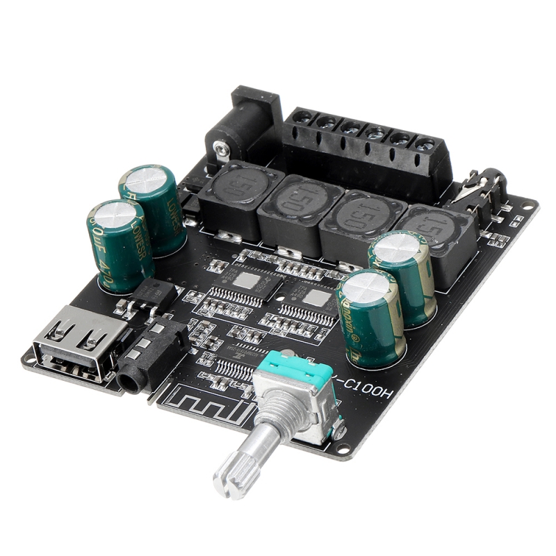

XY-C100H is a high-power Stereo Bluetooth Audio module. Two channel audio signal output. Built-in amplifier module, so it can connect to speaker directly. It is ideal for DIY wireless Bluetooth speakers and transponders.
It can work with Sinilink App which can display can monitor current voice source and change equalizer.
Product Name: XY-C100H 100W*2 HiFi Bluetooth Amplifier Module
Item No.: XY-C100H
Working voltage: DC 5.0V~26V
Amplificateur IC:TPA3116D2
Control type: Sinilink Bluetooth/APP control
Audio input type: Bluetooth / AUX / U-disk / PC USB sound card
version Bluetooth: BLE 5.0
Communication distance: 15 meters (Max)
Channel: dual channel stereo output
Output impedance: 4ohm~16ohm
Matching speaker: 10W~300W
Sortie Audio: sortie audio Active/Passive
Output power:
Output power 30W*2 at 12V 8ohm
Output power 40W*2 at 12V 4ohm
Output power 36W*2 at 15V 8ohm
Output power 60W*2 at 15V 4ohm
Output power 64W*2 at 19V 8ohm
Output power 90W*2 at 19V 4ohm
Output power 80W*2 at 24V 8ohm
Output power 100W*2 at 24V 4ohm
reverse connection protection: yes
overheating protection: yes
short circuit protection: yes
overvoltage protection: yes
undervoltage protection: yes
Operating temperature range: -40℃~85℃
Working humidity range: 5%-95% RH
Module size: 70*65*18mm
