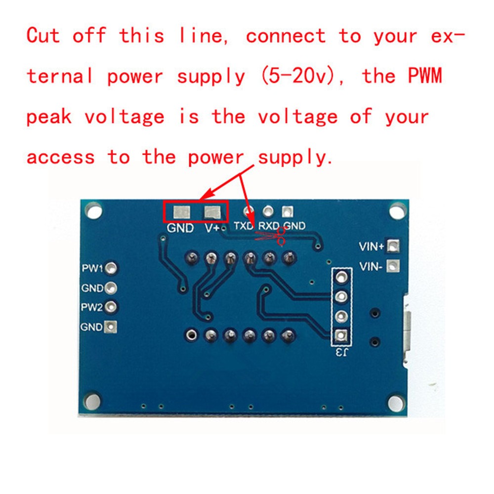

5. Output amplitude: default 5V V-pp (can be changed by external power supply);

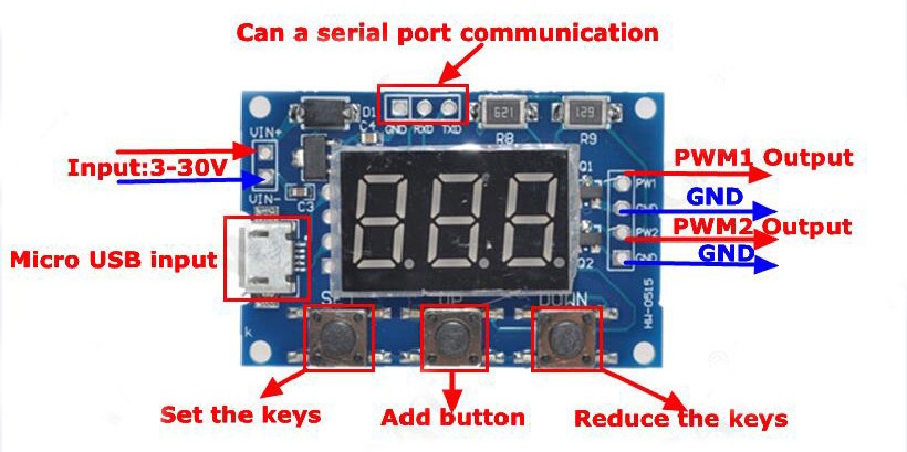

The module has three buttons: Set , Up , Down ;
1. By briefly pressing the [ Set ] key , the display of four parameter values (FR1 : PWM1 frequency ; d U1 : PWM1 duty cycle ; FR2 : PWM2 frequency ; dU2 : PWM2 duty cycle ) , there will be a corresponding switch The parameter name flashes prompt.
2. Press [ Up ] and [ Down ] directly to modify the current parameter value ( long press can be added quickly or quickly).
3. The two PWMs are pre-configured with three kinds of frequency values. In the frequency display interface, the long-pressing [ SET ] key is used to switch, and the duty ratios of the three frequencies are the same . ( XXX: range 1Hz ~ 999Hz ; XX.X : the range of 0.1 Khz ~ 99.9Khz ; XXX : range 1Khz ~ 150 Khz , ) .
