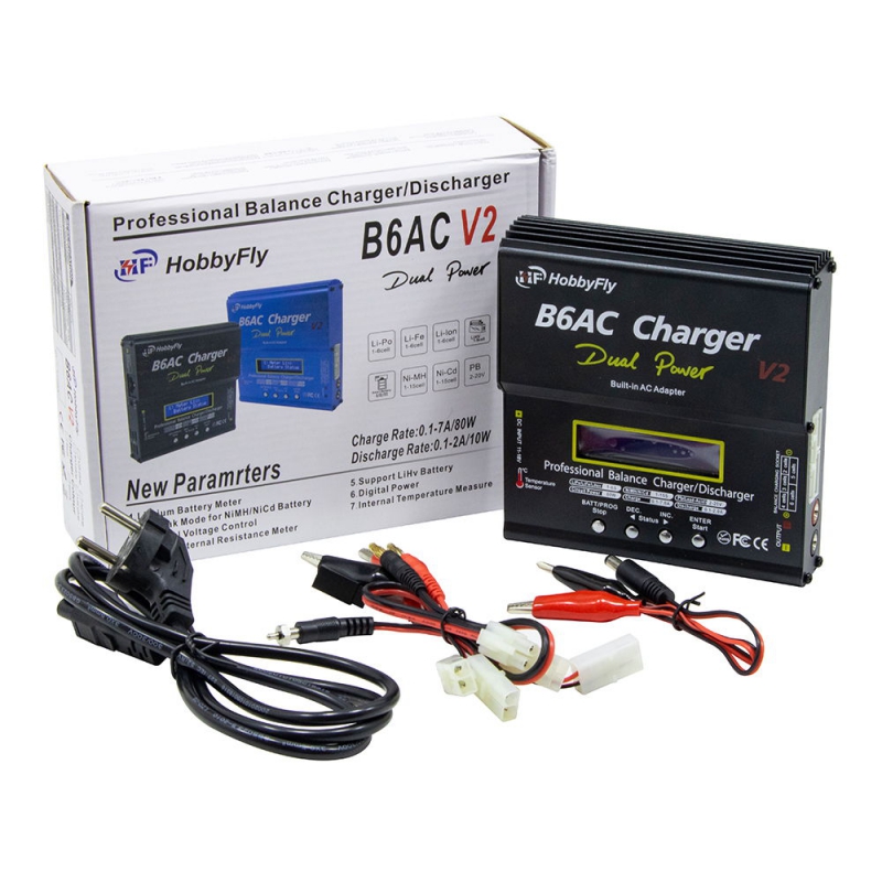

دستگاه شارژر و دشارژر باتری دارای نمایشگر و پورت بالاس با توان 80 وات و ورودی دوگانه برای شارژ به همراه کلیدهای کنترلی
این محصول شارژر مدل  B6AC V2 است که دارای ورودی دوگانه برای شارژ می باشد. این شارژر توسط میکرو پردازنده ها کنترل شده و دارای قدرت و کارایی بسیار بالایی است. با استفاده از این شارژر میتوانید از لحاظ ایمنی باتری اطمینان داشته باشید و ولتاژ هر سلول را به صورت جداگانه مانیتور کنید.
HobbFly B6AC V2 new features compared with old version:
Battery Capacity,Voltage checker;
Terminal Voltage Control(TVC),you can set the battery ended voltage as you want; For example,you can set each cell 4.00v ended for your lipo battery charging;
Digital Power output;you can use it as a power adapter:5V-27V DC,0.1-7A current;
With Internal sensor monitor to avoiding high temperature for protect charger and battery and your home;
Auto identify the battery cells count when charge,you don't need to adjust it any more;
Support LiHv 4.35V battery and smart battery charge;
There are charging precision option: fast charge,standard precision, accuracy;
Charger resetting option; So B6AC V2 charger can better meet your needs with supporting a variety of battery types.It has 80W high power,Max 7A charging current, this RC lipo balance charger can balance, fast charging, data storage(20pcs), cyclic charging and discharging and much more for all of your battery packs.It is designed with protection avoiding Reverse Polarity/Short Circuit/Over-Charge/Over-Current/Over-Temperature.
Specifications
-New Features see above 1-9 points;
-Digital Power Output: DC 5-27V, Current:0.1-7A
-Input Voltage: DC:11-18V AC: 100-240V
-Charge Current: 0.1-7.0A,Discharge Current: 0.1-2.0A;
Balance Current: 300mA /cell
-Charge Power: Max.80W,Discharge Power: Max.10W
-Li-Ion /LiPo/LiHv/ Polymer cell count : 1 6 series;
-LiFePO4 Battery voltage: 3.2V to 19.2V
-NiCd / NiMH battery cell count : 1 15 cell; 1.2V to 18V
-Pb battery voltage :2V 20V
-Internal Temp sensor:Yes; Outer Temp Sensor port: Yes
-Dimension: 210 165 50mm(L W H);Weight:750g;
Built-in Balance: Yes

    سلام وقتتون بخیر آیا کابل هایی که در تصویر هست هم درجعبه وجود دارد ؟ واینکه این محصول اصل هست ؟
    • پشتیبانی | 12 ماه پیش
      محمد یاسین داودنیا سلام تمامی سیم و کابل‌های قابل مشاهده در تصویر اول کالا به صورت کامل ارسال میگردد
