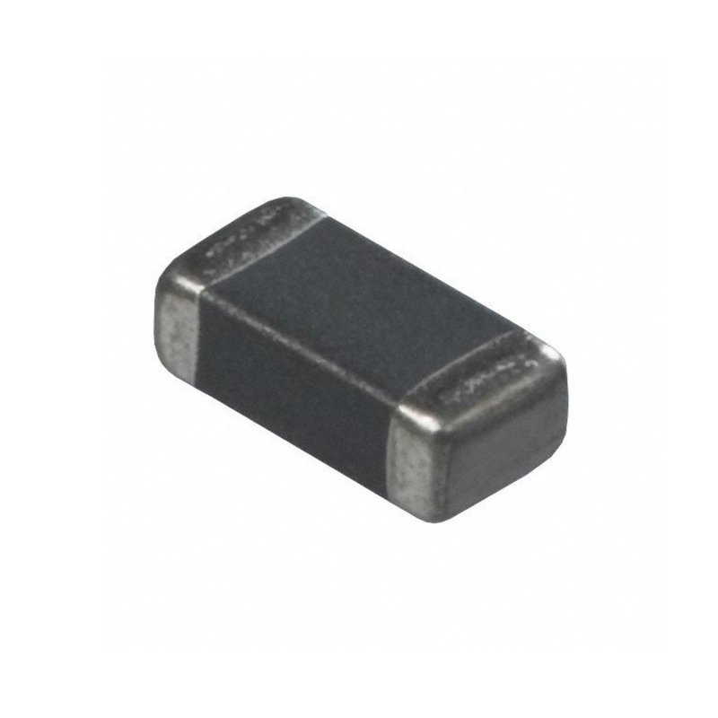

Description: INDUCTOR MULTILAYER 33UH 1206
Inductance: 33uH
Current Rating: 25mA
Tolerance: 10%
Material-Core: Ferrite
Type: Ferrite Core
Shielding: Unshielded
DC Resistance (DCR): 1 Ohm Max
Q @ Freq: 50 @ 2MHz
Frequency - Self Resonant: 24MHz
Operating Temperature: -40°C ~ 125°C
Package / Case :1206 (3216 Metric)
Size / Dimension: 0.125" L x 0.063" W x 0.024" H (3.20mm x 1.60mm x 0.80mm)
Mounting Type: Surface Mount
Frequency - Test :2MHz
Manufacturer: Well
Lead-Free Status
RoHS Status
