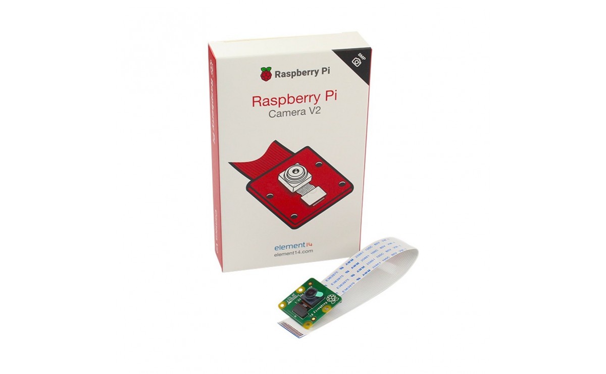

IMX219 یک حسگر فوکوس ثابت دارد و می تواند عکس هایی با کیفیت 3280 در 2464 پیکسل و همچنین ویدئوهای 1080p HD با نرخ 30 فریم بر ثانیه از سوژه هایش بگیرد.  حسگر سونی به خاطر کیفیت تصویر بالا، طراوت و تازگی رنگ ها و عملکرد خوبش در نور کم انتخاب شده که بعد از بهینه سازی های لازم، عملکرد خوبی را با واحد پردازش گرافیکی Videocore IV رزبری پای از خود به نمایش گذاشته است.
The Raspberry Pi Camera Module V2 is the new and improved official camera board from the Raspberry Pi Foundation! Custom designed and manufactured by the Raspberry Pi Foundation in the UK, the Raspberry Pi Camera Board V2 features an ultra-high quality 8 megapixel Sony IMX219 image sensor (up from 5MP on the V1 camera board), and a fixed focus camera lens. The V2 camera module is capable of 3280 x 2464 pixel static images, and also supports 1080p30, 720p60 and 640x480p90 video.
The module attaches to Raspberry Pi by way of a 15 Pin Ribbon Cable, to the dedicated 15-pin MIPI Camera Serial Interface (CSI), which was designed especially for interfacing to cameras. The CSI bus is capable of extremely high data rates, and it exclusively carries pixel data to the BCM2835 processor. A 150mm CSI cable is included with every camera.
The board itself is tiny, at around 25mm x 23mm x 9mm, and weighs just over 3g, making it perfect for mobile or other applications where size and weight are important.
Fixed focus lens on-board
150mm CSI camera cable included
8 megapixel native resolution sensor-capable of 3280 x 2464 pixel static images
Supports 1080p30, 720p60 and 640x480p90 video
Size 25mm x 23mm x 9mm
Weight just over 3g
Connects to the Raspberry Pi board via a short ribbon cable (supplied)
Camera v2 is supported in the latest version of Raspbian, Raspberry Pi's preferred operating system
