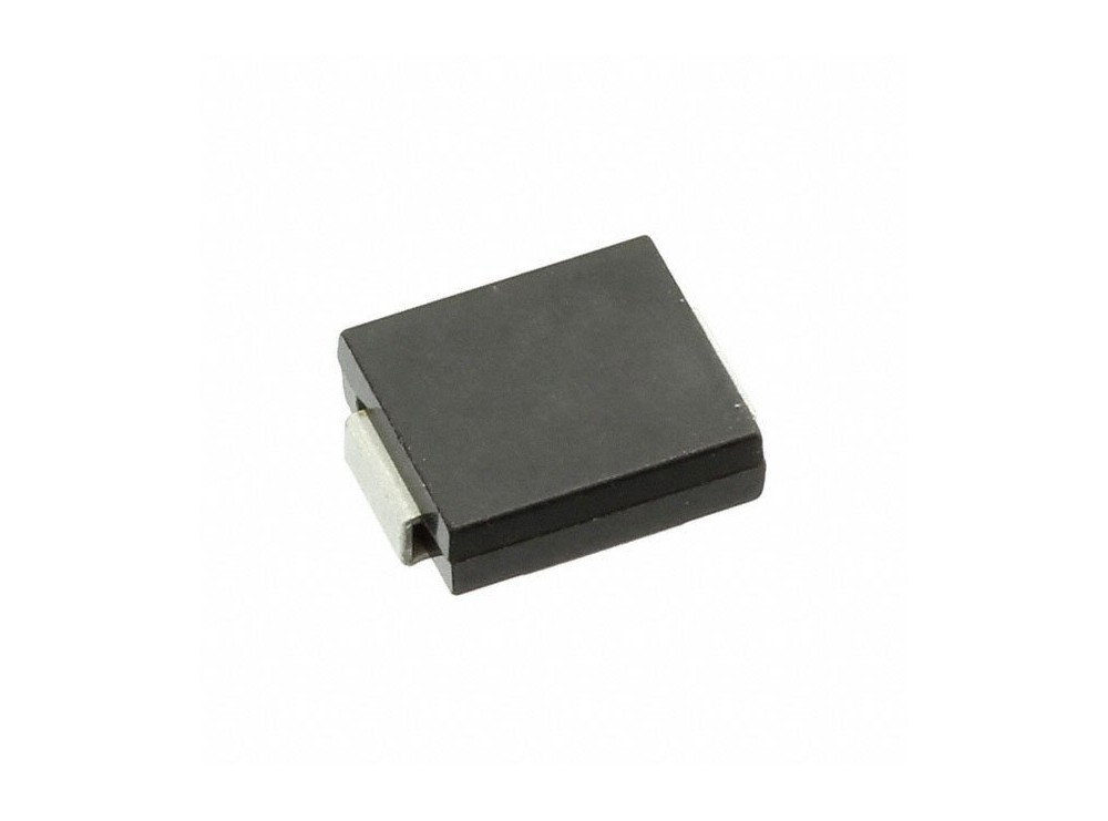

دیود TVS Unidirect پکیج SMC کد 1.5SMC12A
کد کالا: 2041004233
دیود TVS Bidirect تی وی اس 10.2 ولت 1500 وات 1.5SMC12A پکیج SMC
Product Category:ESD Suppressors / TVS Diodes
Product Type:TVS Diodes
Polarity:Unidirectional
Working Voltage:10.2 V
Number of Channels:1 Channel
Termination Style:SMD/SMT
Package / Case: DO-214AB-2
Breakdown Voltage:11.4 V
Clamping Voltage:16.7 V
Pppm - Peak Pulse Power Dissipation:1.5 kW
Vesd - Voltage ESD Contact:30 kV
Vesd - Voltage ESD Air Gap:30 kV
Cd - Diode Capacitance: -
Ipp - Peak Pulse Current:91 A
Minimum Operating Temperature:- 65 C
Maximum Operating Temperature:+ 150 C
Series:1.5SMC
Pd - Power Dissipation: 6.5 W
Subcategory: TVS Diodes / ESD Suppression Diodes
Vf - Forward Voltage: 3.5 V
