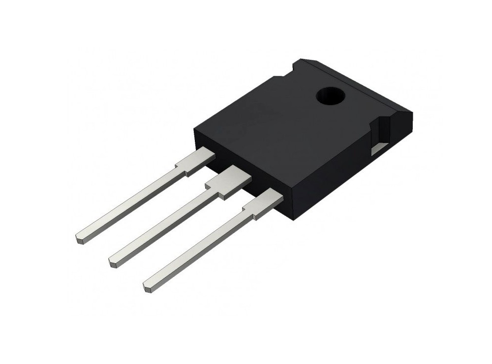

دوبل دیود شاتکی SR3060PT 30A,60V
کد کالا: 2041003032
9 رای‌دهنده
Type Schottky Diode
Configuration Dual Common Cathode
Peak Reverse Repetitive Voltage (V) 60
Maximum Continuous Forward Current (A) 30
Peak Non-Repetitive Surge Current (A) 300
Peak Forward Voltage (V) 0.7@15A
Peak Reverse Current (uA) 1000
Minimum Operating Temperature (°C) -55
Maximum Operating Temperature (°C) 150
DATASHEET
