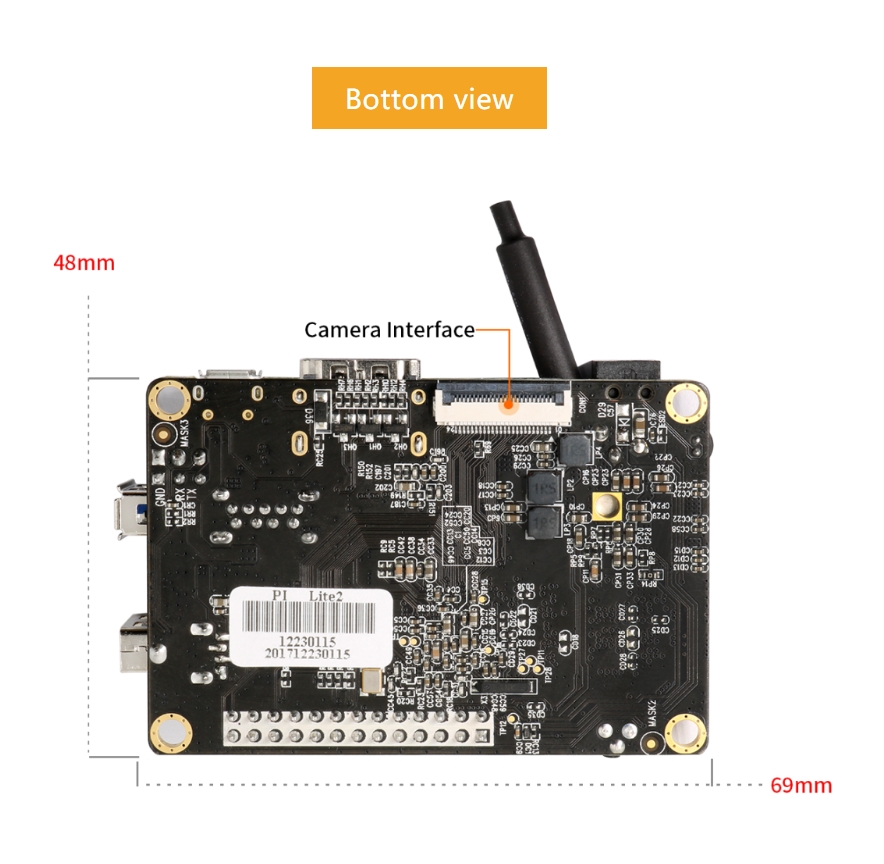

Camera – Parallel CSI connector with support 5MP camera up to 1080p30

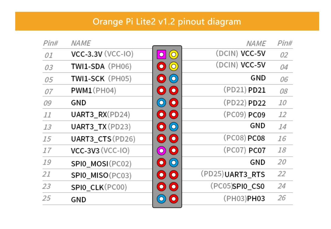

Expansion – 26-pin header

Dimensions – 69 x 48 mm
Weight – 50 grams
