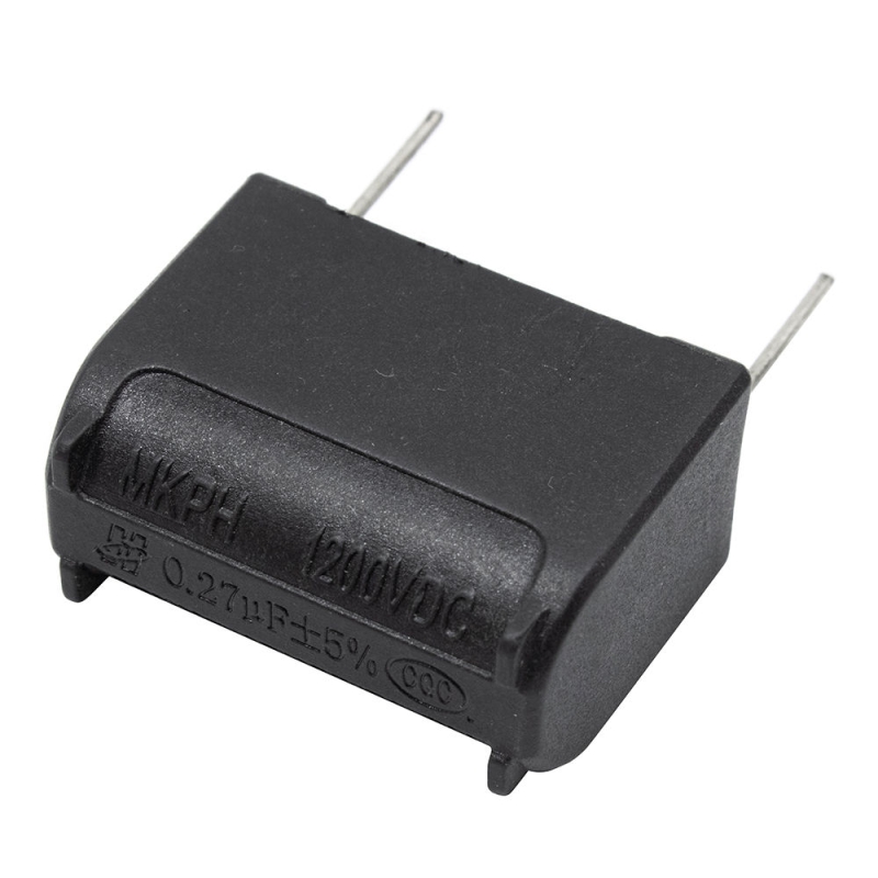

خازن 0.27 میکروفاراد 1200ولت نوع MKPH  مناسب استفاده در کوره القایی
2.3
(3 رأی‌دهنده)
1,650,000 ریال
نوع : MKPH
ظرفیت : 0.27 میکرو فاراد
ولتاژ کاری :1200
ابعاد خازن : 35x15x24  میلی متر
فاصله بین پایه ها:29 میلی متر
رنگ : مشکی
ویژگی ها
دارای مقاومت عالی در برابر شعله و ضد رطوبت
تلفات کم، مقاومت عایق بالا و افزایش اندک دمای داخلی
کاربرد
مدارهای ولتاژ بالا
 مدارهای فرکانس بالا و پالس
مناسب برای کوره های القایی
اینورترها و سایر مدارهای تشدید
This 0.33uf 1200V DC Induction Cooker Capacitor is designed with high reliability and long life with high ripple current at high frequency and excellent smoothing ability. These capacitors offer a wide range of applications in the field including high-frequency oscillating loop applications with high pulse current stress such as induction rice cooker, induction cooktop and protection circuits in switched-mode power supply (SMPS) and electronic ballasts.
A DC Box capacitor designed with polypropylene dielectric with double metalized polyester film as electrodes. The two leads come in parallel with the body of the capacitor. These leads come out at the same ends of the capacitor. Meanwhile, these capacitors are encapsulated in epoxy resin in a plastic box of material and end sealed. Moreover, these box capacitors are ideal for low-profile circuit board applications. This capacitor made up of Polypropylene Film operates at a rated voltage of 1200V DC.
DC Box capacitors generally exist as polarized, with one lead being positive and therefore the other being negative. Typically these capacitors tend to possess a sign on the positive side to denote which lead is positive. However these electrolytic capacitors also can be non-polarized, but they’re not as popular because of the polarized variants. And also the high-temperature resistance of polyester material is 185 Fahrenheit degrees.
Capacitance: 0.27uf
Voltage Rating: 1200VDC
Dielectric Type: Double Metallized PP
Capacitance Tolerance: ± 5%
Capacitor Case Style: Radial Box
Dissipation Factor: ≤0.0008 at 10kHz
Capacitor Terminals: Radial Leaded
Operating Temperature Min: -55°C
Operating Temperature Max: 105°C
Automotive Qualification Standard
High Accuracy, Long-Life Polyester Film Capacitor
Low Leakage
Easy Mounting
Metallised polypropylene( MPP) film capacitor
Non-inductive structure
Automatic production to ensure stable quality
Especially for the high-frequency oscillating loop[circuit of induction heating device].
