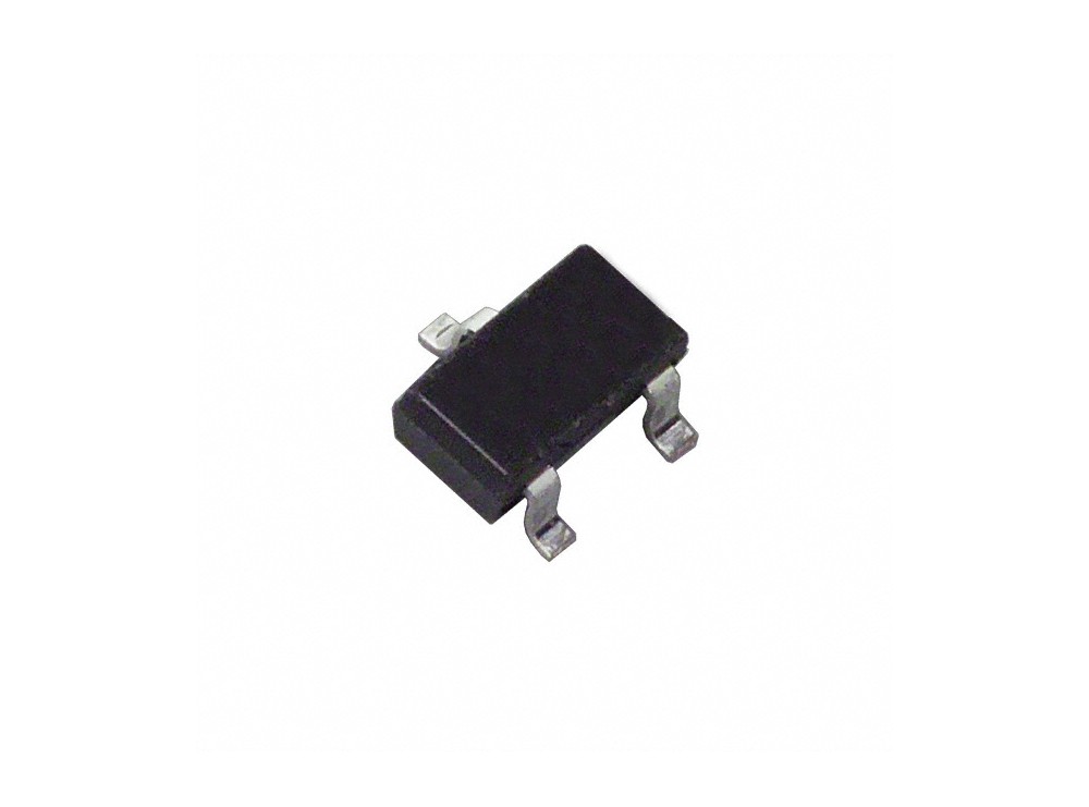

ترانزیستور MMBTA92 نوع PNP پکیج SOT-23
کد کالا: 2111002147
ترانزیستور MMBTA92 نوع PNP پکیج SMD SOT-23 ولتاژ 300V جریان 100mA

Type Designator: MMBTA92
SMD Transistor Code: 2D_7Ep_7Et_7EW
Material of Transistor: Si
Polarity: PNP
Maximum Collector Power Dissipation (Pc): 0.35 W
Maximum Collector-Base Voltage |Vcb|: 300 V
Maximum Collector-Emitter Voltage |Vce|: 300 V
Maximum Emitter-Base Voltage |Veb|: 5 V
Maximum Collector Current |Ic max|: 0.1 A
Transition Frequency (ft): 50 MHz
Collector Capacitance (Cc): 6 pF
Forward Current Transfer Ratio (hFE), MIN: 25
Noise Figure, dB: -
Package: SOT23
