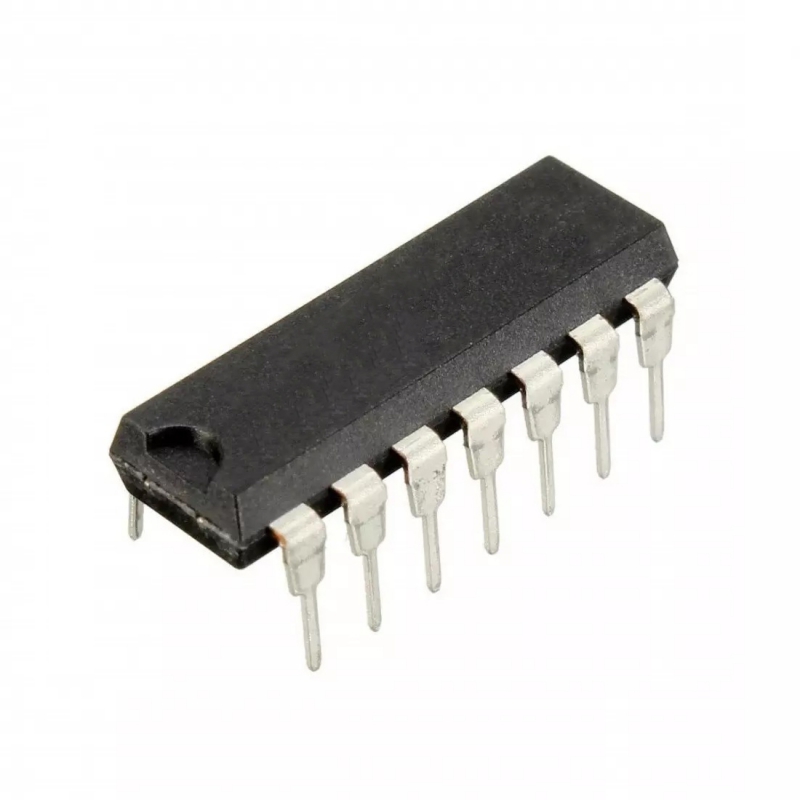

تراشه آپ امپ توان پایین 4 تایی TL074 JFET پکیج DIP
کد کالا: 2101008006
آی سی آپ امپ توان پایین 4 تایی TL074 JFET پکیج DIP

Product Category: Operational Amplifiers - Op Amps
Mounting Style: Through Hole
Package / Case: PDIP-14
Supply Voltage - Max: 36 V
Number of Channels: 4 Channel
GBP - Gain Bandwidth Product: 3 MHz
SR - Slew Rate: 13 V/us
CMRR - Common Mode Rejection Ratio: 70 dB to 100 dB
Ib - Input Bias Current: 200 pA
Vos - Input Offset Voltage: 6 mV
Supply Voltage - Min: 7 V
Operating Supply Current: 1.4 mA
Shutdown: No Shutdown
Series: TL074
Packaging: Tube
Amplifier Type: Low Noise Amplifier
Height: 1.57 mm
Input Type: Rail-to-Rail
Length: 19.3 mm
Width: 6.35 mm
Product: Operational Amplifiers
Supply Type: Single, Dual
Technology: BiFET
Brand: Texas Instruments
Dual Supply Voltage: +/- 5 V, +/- 9 V, +/- 12 V, +/- 15 V
en - Input Voltage Noise Density: 18 nV/sqrt Hz
In - Input Noise Current Density: 0.01 pA/sqrt Hz
Maximum Dual Supply Voltage: +/- 18 V
Minimum Dual Supply Voltage: +/- 3.5 V
Operating Supply Voltage: 7 V to 36 V, +/- 3.5 V to +/- 18 V
