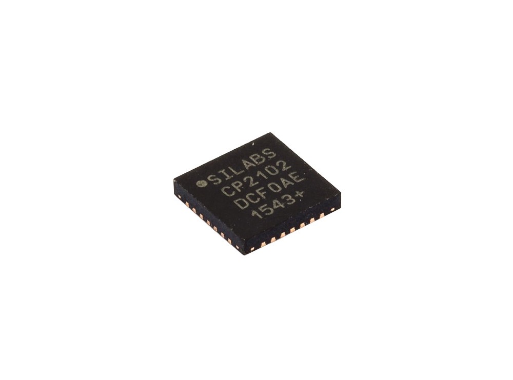

تراشه مبدل USB به سریال CP2102 پکیج QFN-28
کد کالا: 2101004010
آی سی مبدل USB به UART سریال CP2102 پکیج QFN-28 SMD
Single-Chip USB to UART Data Transfer
- Integrated USB transceiver; no external resistors
required
- Integrated clock; no external crystal required
- Internal 1024-byte programmable ROM for vendor ID,
product ID, serial number, power descriptor, release
number, and product description strings
- EEPROM (CP2102)
- EPROM (One-time programmable) (CP2109)
- On-chip power-on reset circuit
- On-chip voltage regulator
- 3.3 V output (CP2102)
- 3.45 V output (CP2109)
- 100% pin and software compatible with CP2101
USB Function Controller
- USB Specification 2.0 compliant; full-speed (12 Mbps)
- USB suspend states supported via SUSPEND pins
Asynchronous Serial Data BUS (UART)
- All handshaking and modem interface signals
- Data formats supported:
- Data bits: 5, 6, 7, and 8
- Stop bits: 1, 1.5, and 2
- Parity: odd, even, mark, space, no parity
- Baud rates: 300 bps to 1 Mbps
- 576 Byte receive buffer; 640 byte transmit buffer
- Hardware or X-On/X-Off handshaking supported
- Event character support
- Line break transmission
Virtual COM Port Device Drivers
- Works with existing COM port PC Applications
- Royalty-free distribution license
- Windows 8/7/Vista/Server 2003/XP/2000
- Mac OS-X/OS-9
- Linux
Manufacturer: Silicon Laboratories
Product Category: USB Interface IC
RoHS: Details
Mounting Style: SMD/SMT
Package / Case: QFN-28
Series: CP2102
Packaging: Tube
Brand: Silicon Labs
Operating Supply Voltage: 3.6 V
Product Type: USB Interface IC
