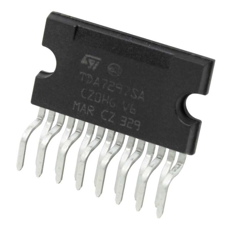

تراشه آمپلی فایر TDA7297SA
کد کالا: 2101012023
آی سی تقویت کننده صوتی آمپلی فایر TDA7297SA دو کانال 10 وات کلاس AB
1,730,000 ریال
Product: Audio Amplifiers
Class: Class-AB
Output Power: 10 W
Mounting Style: Through Hole
Type: 2-Channel Stereo
Package / Case: Clipwatt-15
Audio - Load Impedance: 8 Ohms
THD plus Noise: 1 %
Supply Voltage - Max: 18 V
Supply Voltage - Min: 6.5 V
Maximum Operating Temperature: + 70 C
Description/Function: Speaker
Input Type: Single
Output Current: 2000 mA
Supply Type: Single
Brand: STMicroelectronics
Gain: 32 dB
Number of Channels: 2 Channel
Operating Supply Voltage: 9 V, 12 V, 15 V
Output Signal Type: Differential
Pd - Power Dissipation: 30000 mW
