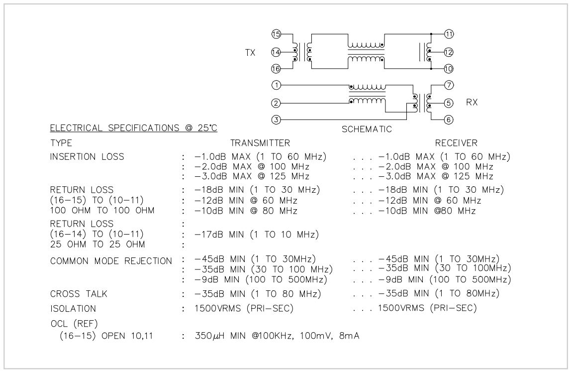

Transmitter / Receiver
Insertion Loss:
- -1.0dB max (1 to 60 MHz)
- -2.0dB max @ 100MHz
- -3.0dB max @ 125MHz
Return Loss
- -18dB min (1 to 30 MHz)
- (16-15) to (19-11): -12dB min @ 60 MHz
- 100 ohm to 100 ohm: -10dB min @ 80 MHz
Return Loss (Transmitter ONLY)
- (16-14) to (10-11): -17dB min (1 to 10 MHz
Common Mode Rejection:
- -45dB min (1 to 30 MHz)
- -35dB min (30 to 100 MHz)
- -9dB min (100MHz to 500 MHz)
Cross Talk: -35dB min (1 to 80 MHz)
Isolation: 1500 VRMS (PRI-SEC)
OCL (ref) (16-15) open 10,11: 350uH min @ 100kHz, 100mV, 8mA
