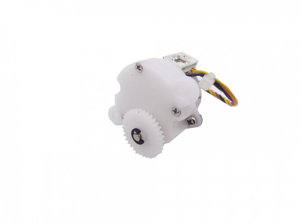

استپ موتور گیربکس 7.5 درجه 24 ولت PM25S-048 دارای چرخ دنده
کد کالا: 3202003032
استپ موتور 7.5 درجه 4 سیمه
Motor Size: PM25S-048
Number of Steps per Rotation: 48 (7.5deg/Step)
Drive Method: 2-2 PHASE
Drive Circui: BIPOLAR CHOPPER
Drive Voltage: 24 [V]
Current/Phase: 400 [mA]
Coil Resistance/Phase:15 [ohms]
gearbox dimensions: 45x11mm
gear dia: 18mm
Drive IC: BD63877EFV
Magnet Material: Nd-Fe-B bonded magnet (MS70)
Insulation Resistance : 100M [ohms] MIN
Dielectric Strength: AC 500 [V] 1 [min]
Class of Insulation: CLASS E (except lead wire)
Operating Temp: -10 [deg.C] - 50 [deg.C]
Storage Temp: -30 [deg.C] - 80 [deg.C]
Operating Hum: 20 [%] RH - 90 [%] RH
