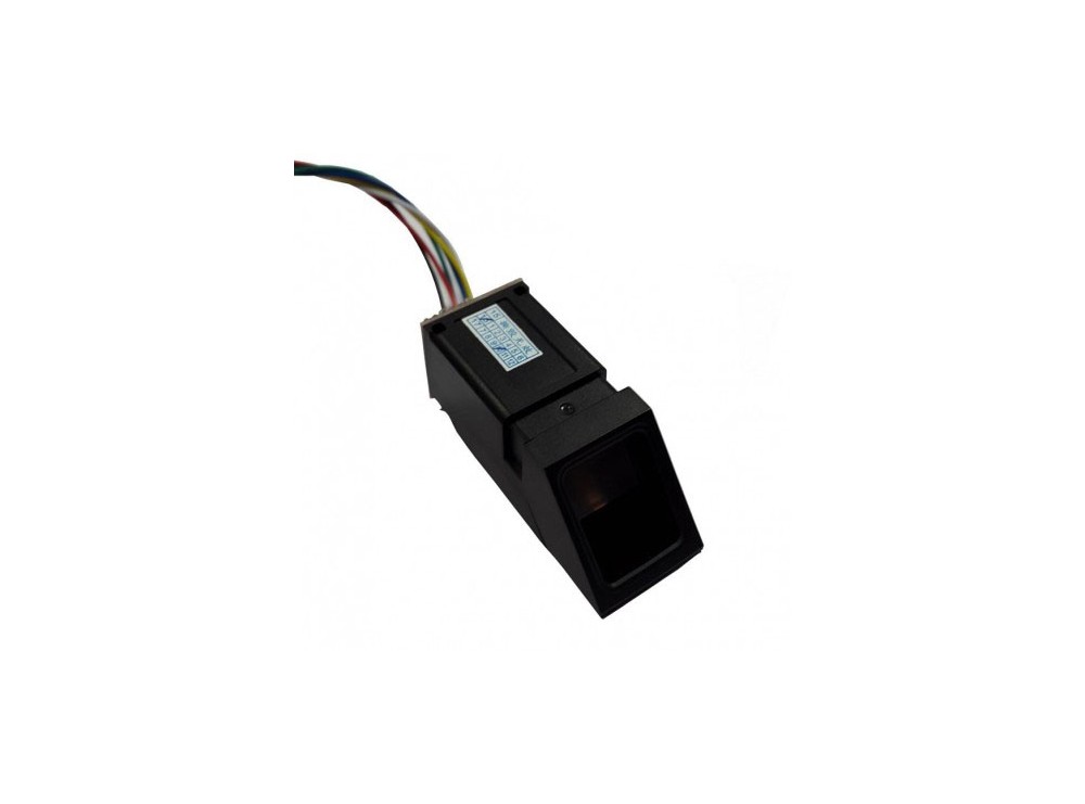

ماژول اثر انگشت ZFM60
3011019005
ماژول اثر انگشت اسکنر نوری ZFM60 ورژن 1.4 دارای پردازنده DSP سرعت بالا و سازگار با رزبری پای و آردوینو
4
(9 رأی‌دهنده)
Power supply voltage: DC 3.8 ~ 7.0V
Backlight color: green
Lighting mode: long light / flashing
Supply current: working current: <65mA
Peak current: <95mA
fingerprint image input time: <0.5 seconds
Window area: 14.5 × 19.4mm
Matching: Matching (1: 1)
Search method (1: N)
Profile: 256 bytes
Template file: 512 bytes
storage capacity: 1000
security level: 3 (from low to high: 1,2,3,4,5)
False Acceptance Rate (FAR): <0.001% (security level is 3)
FRR: <1.0% (when the security level is 3)
search time: <1.0 seconds (1: 500, the mean)
host computer interface: UART (TTL logic level)
Communication baud rate (UART): (9600 × N) bps where N = 1 ~ 12 (the default value is N = 6, namely 57600bps)
Working environment: Temperature: -20 ℃ to +60 ℃
Relative humidity: 40% RH to 85% RH (non-condensing)
storage environment: temperature: -40 ℃ to +85 ℃
Relative humidity: <85% H (no condensation)
Overall dimensions (L × W × H): 54 × 20 × 20.5mm
