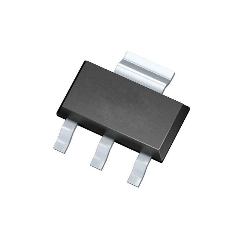

رگولاتور متغیر LD1117STR ADJ پکیج SOT-223
کد کالا: 2120001170
LDO Voltage Regulators 1.25-15V 0.8A Adj
4.3
10 رای‌دهنده
5 دیدگاه
Product Category: LDO Voltage Regulators
RoHS: Details
Mounting Style: SMD/SMT
Package/Case: SOT-223-3
Output Voltage: 1.25 V to 15 V
Output Current: 950 mA
Number of Outputs: 1 Output
Polarity: Positive
Quiescent Current: 10 mA
Input Voltage MAX: 15 V
Output Type: Adjustable
Dropout Voltage: 1 V
Series: LD1117
Packaging: Cut Tape
Packaging: MouseReel
Packaging: Reel
Height: 1.8 mm
Length: 6.5 mm
Width: 3.5 mm
Dropout Voltage - Max: 1.1 V
Voltage Regulation Accuracy: 1 %
Ib - Input Bias Current: 5 mA
Line Regulation: 0.2 %
Load Regulation: 0.4 %
Pd - Power Dissipation: 12 W
Product Type: LDO Voltage Regulators
Reference Voltage: 1.262 V
