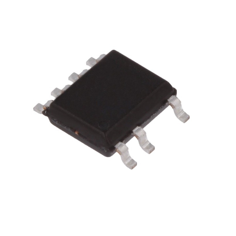

The BP2861CK is a high precision buck constant current LED driver. The device operates in critical conduction mode and is suitable for 85Vac~265Vac universal input offline LED lighting.
The BP2861CKintegrates a 500V power MOSFET. With patent pending MOSFET driving technique, the operating current of the IC is very low. So it doesn’t need the auxiliary winding for supplying the chip. It can achieve excellent constant current performance with very few external components, so the system cost and size are minimized.
The BP2861K utilizes patent pending current control method. It can achieve precise output current and excellent line regulation. The driver operates in critical conduction mode, the output current does not change with the inductance and LED output voltage. The BP2861K offers rich protection functions to improve the system reliability, including LED short circuit protection, VCC under voltage protection, CS resistor short circuit protection and thermal regulation function .
Features
Critical Conduction Mode Operation
Internal 500V Power MOSFET
No Auxiliary Winding
Ultra Low Operating Current
±5% LED Output Current Accuracy
LED Short Protection
Current Sensing Resistor Short Protection
VCC Under Voltage Protection
Thermal Regulation Function
Available in SOP7 Package
Application
LED Candle Light
LED Bulb
Other LED Lighting
