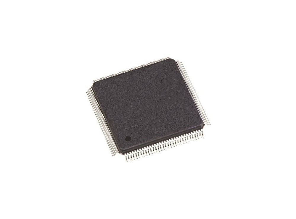

شما با این درایور می توانید به کمک میکروکنترلرهای avr,8051,pic,arm به سادگی السید های تا رزولیشن 864x480x24bit راه اندازی کنید
SSD1963 is a display controller of 1215K byte frame buffer to support up to 864 x 480 x 24bit graphics
content. It also equips parallel MCU interfaces in different bus width to receive graphics data and command
from MCU. Its display interface supports common RAM-less LCD driver of color depth up to 24 bit-perpixel.
• Display feature
− Built-in 1215K bytes frame buffer. Support up to 864 x 480 at 24bpp display
− Support TFT 18/24-bit generic RGB and TTL interface panel
− Support 8-bit RGB interface
− Hardware rotation of 0, 90, 180, 270 degree
− Hardware display mirroring
− Hardware windowing
− Programmable brightness, contrast and saturation control
− Dynamic Backlight Control (DBC) via PWM signal
• MCU connectivity
− 8/9/16/18/24-bit MCU interface
− Tearing effect signal
• I/O Connectivity
− 4 GPIO pins
• Built-in clock generator
• Deep sleep mode for power saving
• Core supply power (VDDPLL and VDDD): 1.2V±0.1V
• I/O supply power(VDDIO): 1.65V to 3.6V
• LCD interface supply power (VDDLCD): 1.65V to 3.6V
