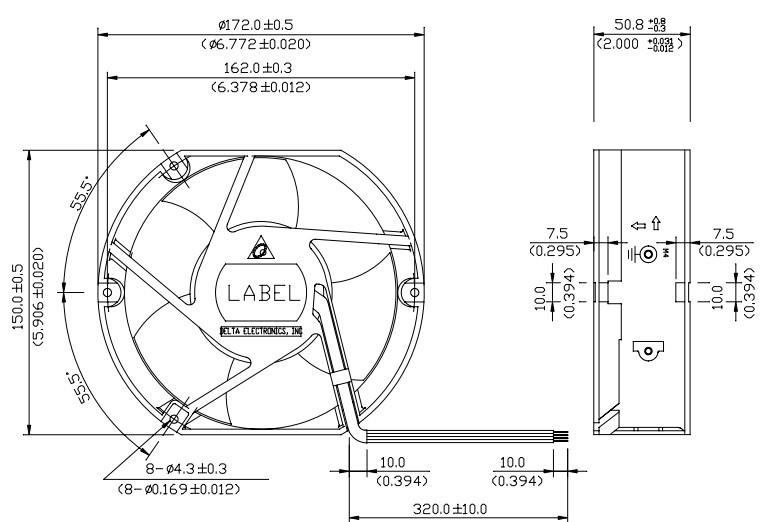

مارک: DELTA ELECTRONICS
مدل: EFB1548VHG
ولتاژ: 48 ولت DC
جریان مصرفی: 0.83 آمپر
سایز: 172X150X25 میلی متر
ضخامت: 25 میلی‌متر
تعداد سیم: 2 سیمه
Series : EFB
Part Status : Enabled
Voltage Rated : 48 VDC
Size / Dimension : Rounded/Rect-172mm L x 150mm H
Width : 50.80mm
Air Flow : 302.29CFM (8.560 m3/min)
Static Pressure : 0.937 inchH2O (23.80 mmH2O)
Bearing Type : Ball
Fan Type : Axial
Features : PWM Control, Speed Sensor (Tach)
Noise : 60.0 dB(A)
Power (Watts) : 23.52 W
RPM : 4000 RPM
Termination : 4 wire leads
Ingress Protection : IP54
Operating Temperature : -10~+70⁰C
Weight gram (g) : 840g
Current Rating : 0.49 A
Voltage Rating : 36.0 - 60.0 VDC
Material Frame : Die-Casting Aluminum
Material Blade : Plastic
Lifetime @ Temp80000 Hrs@40⁰C
