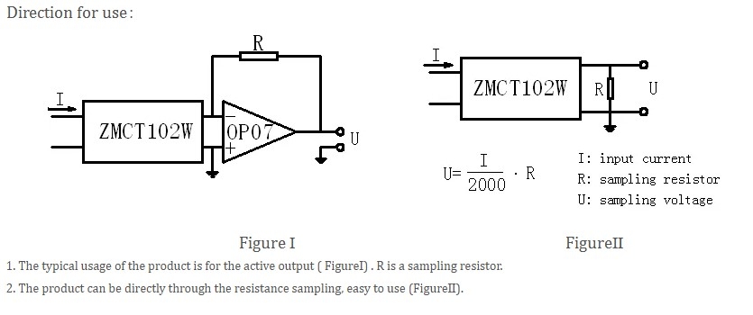

Model ZMCT102W
input current 0~20A (sampling resistor 100Ω)
Rated output current 2.5mA at input 5A
turns ratio 2000:1
phase angle error ≤30'(input 1A, sampling resistor 100Ω)
Accuracy class 0.2
linearity ≤0.2% (5%dot~120%dot)
Permissible error -0.2%≤f≤+0.2% (input 1A, sampling resistor 100Ω)
isolation voltage 4500V
application the precise measurement of current and power
Encapsulation Epoxy
installation Output leads installation (conventional lead length shown in drawing)
operating temperature -40℃~+85℃
