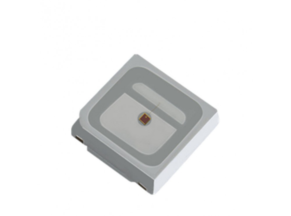

The SMD LED Module (surface-mount device light-emitting diode module) is a type of LED module that uses surface-mount technology (SMT) to mount LED chips on printed circuit boards (PCB). It is a self-contained surface-mount LED device designed either to function on its own or to plug into a compatible unit. The types of SMD LED Modules are distinguished by the dimensions of the LED package. The package dimension of SMD LED 5054 is 5.0mm*5.4mm.
Feature
  • Compact package size at 5.0mm*5.4mm.
  • Voltage:3.0-3.1V
  • current150mA(0.5W)
  • Lumen:20-22LM
  • CCT:1800-2000K
  • Various configurations of different voltage and die count to meet a wide range of application requirements.
  • Deliver high efficacy and quality of light for the distributed light sources.
  • Excellent Color Reproduction.
  • RoHS complain.
  • Low thermal resistance.
  • Environment-friendly.
  • Long life span and high reliability.

  • Reza alizadeh | 7 سال پیش خریدار
    اگر یک وات هستن چرا پس زدین 20 تا 22 لومن این نمونه ها زیر 100 تا 140 لومن نیستن؟
    • پشتیبانی | 7 سال پیش
      Reza alizadeh توان ال ای دی ها نیم وات بوده و طبق اطلاعات ارائه شده از طرف سازنده مقدار لومن در محدوده 20 تا 22 می باشد.
  • Hadi e | 7 سال پیش
    چند وات هست؟
      Hadi e دارای توان 0.5W می باشد.
