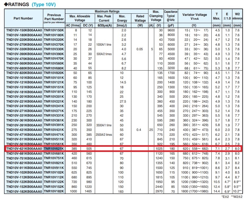

Features
Large surge capability (the surge current ratings of TNR V series, by 8/20 µs, are about two
times larger than TNR G series).
Large energy capability (1.5 time larger than TNR G series).
One rank smaller TNR V has same peak current as TNR G.
Excellent voltage non-linear coefficient.
Low clamping voltage.
Symmetrical V-I characteristics (No polarity).
Fast response.
Stable characteristics against repeated surges.
Superior temperature characteristics.
High reliability
●UL, CSA and VDE recognized components
UL 1449 3rd File : E323623
UL 1414 File : E65426 (Except "12V")
CSA File : LR97864
VDE File : 118623
Applications
Protection for semiconductors from over voltage.
Protection for electronic instruments from lightning surges.
Absorption of on-off surges from motors and relays.

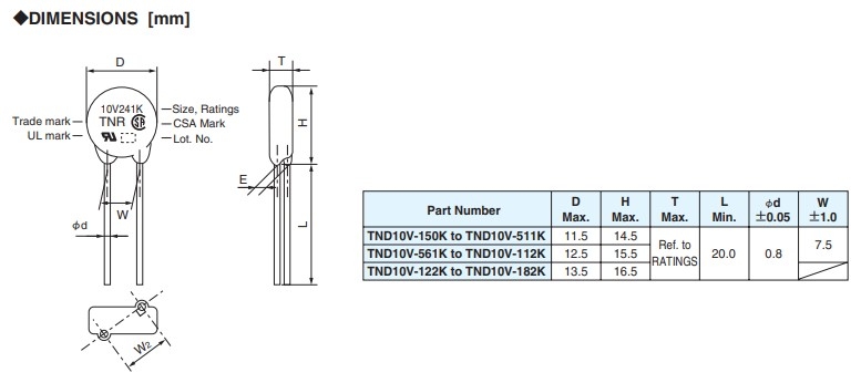

◆PART NUMBERING SYSTEM
Operating Temperature Range: -40 to +85℃
Storage Temperature Range: -50 to +125℃
